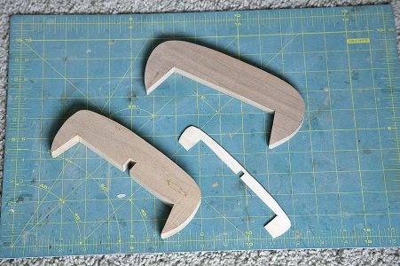

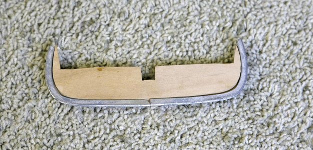

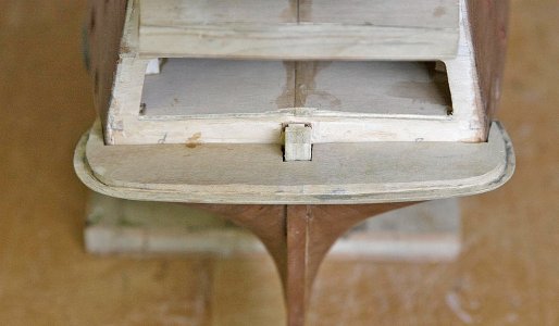

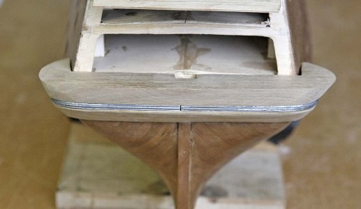

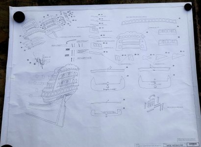

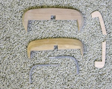

I was nearing the part of the build that I was dreading the most, the stern gallery support and the galleries themselves. Until I started I didn’t know how I was actually going to get it done. In the kit there were a couple of pre shaped pieces of wood, the third and thinnest was missing so I made one up off the plan. Remember there are no instructions, I’ve shown the plans for this area and I think you’ll agree they’re not really a great help, there was a lot of head scratching but I eventually managed. The pictures show the sequence, I later found that this was the easy bit!

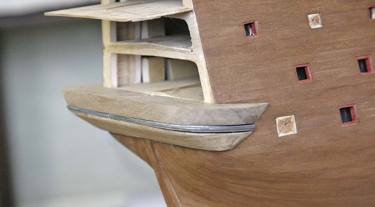

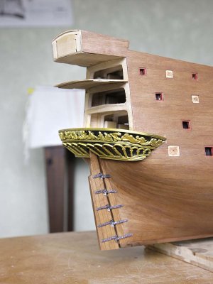

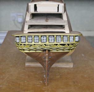

Following on from yesterdays post: I completed the lower transom support. Before glueing into place, it needed quite a bit of sanding to get its final correct shape and fit. Some filler was needed, then a coat of sealer. I really should have left painting and fitting the castings until much later but I was impatient to see how it would look. I painted the support black, shaped the castings, painted them gold and attached, it gave me the wow factor and the encouragement to get this very ornate area done.

That combination gives a real ‘Royal’ look, Ken.

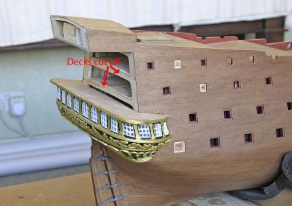

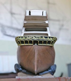

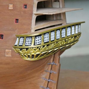

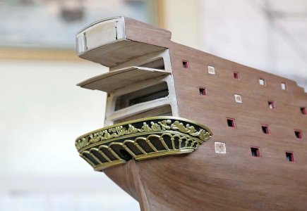

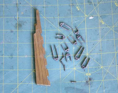

Todays update is the rudder and more of the gallery. I shaped the rudder according to the plans and scribed it. The hinges and pintles are cast and were quite chunky, they were obviously not as scaled as PE. but I rather liked them, they suited the model. I filed the bolt heads down a bit as they were too proud, I blackened them and glued them to the rudder and hull.

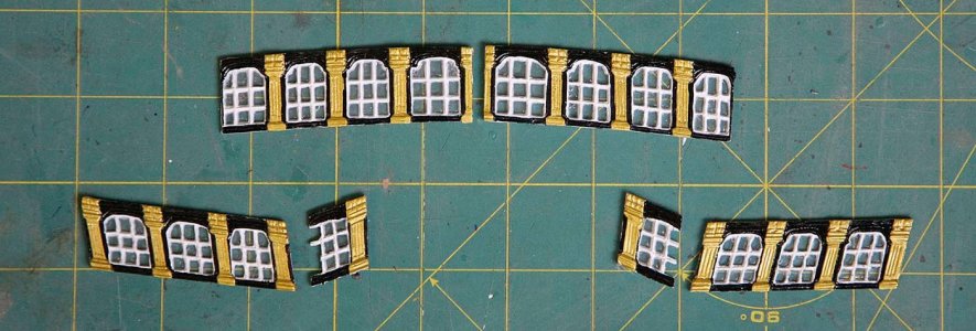

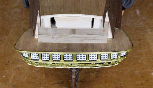

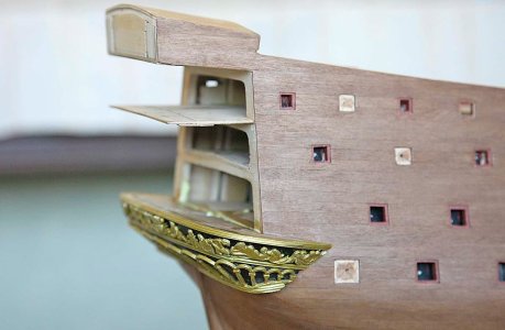

Next I selected the lower set of cast windows, I had already filed open the glazed area in preparation, I painted and glazed them using a clear glue before fitting them into place. After fitting the cast trim above the windows I planked the next level. I couldn't figure out why the middle deck extended as far back as it did as it would prevent the next level of gallery from fitting so I decided to just remove it, it turned out to be the correct decision.
I was expecting to be able to shape the castings around complex curves and for it to stay flat against the surface like photo etch but it's a different beast, it's quality lies in its depth and rich detail but it should not be viewed from too close up to see it at it's best.
It was all coming along quite well for now!!!
