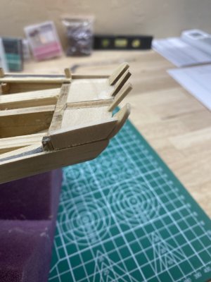

While continuing to sand and refine the hull I decided to continue with the transom framing. There are 2, 1/16" circular pieces that go on the upper edges of the stern blocks. Unfortunately they were not included with my used kit. I made a copy of the plans and cut cut out the diagram of these pieces and copied them onto a piece of scrap. I aligned it so it would not be weakened by the flow of the grain. i cut these 2 pieces out and sanded the edges together to produce 2 identical shapes.
I then carefully notched the appropriate areas on the stern block. Since the rear of the transom is at an angle I set a small straight protractor on the back and taped it into place (any straight object would work). I then glued the pieces into place at the proper angle.
After the glue dried I removed the supports.
I then put 2 smaller support pieces in place in a similar way. When everything was dry I coated the pieces with CA to help strengthen them.

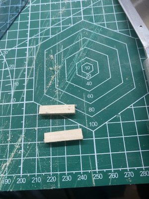

Back again in Tucson. I have family visiting so it will be even more on and off again. I spent some time sanding the hull a bit more. I am very happy with how it looks, I have ordered the Rustolum automatic spray primer/putty. I have read reviews of this stuff and it has been very favorable. Apparently a lot of people doing 3D printing use it to eliminate the layering look of the printing. Until iy arrives I am working on other parts. I made two "tumble" pieces That are suppose to help with the transition between the stern and the transom. I got 2 Scrap pieces a little longer than the space between the stanchion and the back support.
I ambled the pieces to fit the space.

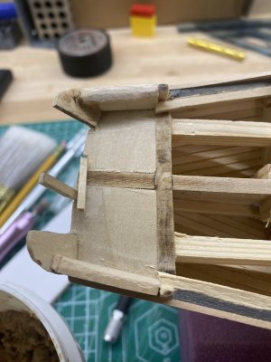

These were glued into place and shaped with the drum sander I have attached to my nail drill.
You can see that not surprisingly one of the real supports was dislodged due to my clumsy hands.

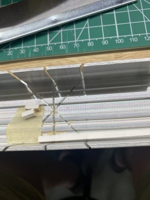

Next up are the bulwarks, infamous scuppers and the stanchions. One thing I have not seen in other build logs are the fact that the stanchions on the foredeck are 1/16" taller then the ones on the quarterdeck. Of course I cut all the stanchions (which are made of 1/8" strip) the smaller size. These stanchions will also be painted white along with the bulwarks inner wall. You can save yourself some time and effort by pre-painting the 1/8" strip before you cut it (something i thought about only after making all the smaller stanchions.) Be that as it may, I used a "jig" which was basically a piece of tape placed on the motor box to determine the length of each cut.
This worked out quite well.
