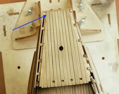

That's great instruction for those who are considering this as a build.Lower Transom planking Port side:
I started by being a bit more agressive "fairing" this part of the frame.
The next step was to remove the char, lightly sand and glue the planks together as one piece.
Then a few dry fits to get a good fit.
Followed by a final check for a bit of overlap.
With a "filler" piece added the plank assembly was glued in place.
Today is a repeat for the Starboard side.

Yup, I had to think about it, I could not get a good fit with my initial fairing of that frame.That's great instruction for those who are considering this as a build.

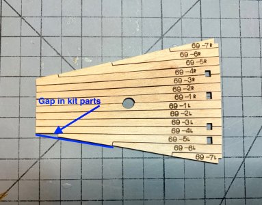

I'm having a great time withn this build. Still a long way to go.Nice symmetry, Jan! You're getting good at this thing!

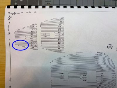

Yup, that section has the laser marks on the reverse side. It doesn't matter how I try to fit them, one side winds up odd.Interesting ... the drawing of the flat shows the parts in the correct orientation - it appears that between there and the laser, one part got flipped over. Does the odd section have the rectangular laser marks on the reverse side?
