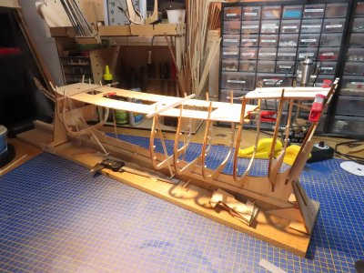

So, now starting to get somewhere. I drew the keel, stem, stern and frames (bulkheads) up in SolidWorks and mated them together. After checking with 3D curves, I realize that a couple of frames need some minor adjustments, but otherwise no big issues.
As I now have material enough for making new frames, I think I will start cutting them and and make a dry fit to see if it's okay before I take a trip to the museum, guess some further questions will pop up as I go along
