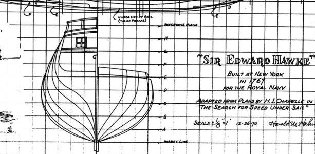

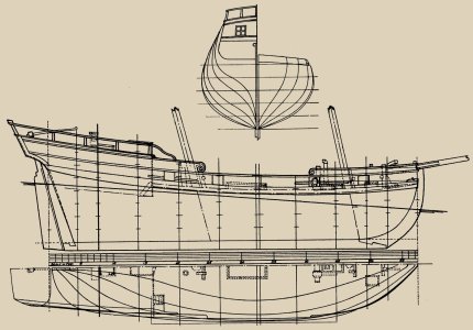

Now that the model is finished the next couple post will be a review of the build starting with the stern windows. This is the Hahn drawing
he used Howard Chalelle as his reference

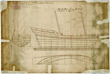

Howard Chapelle made up the stern a reconstruction because the stern is not drawn on the original

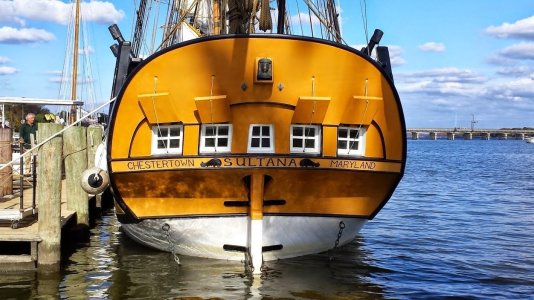

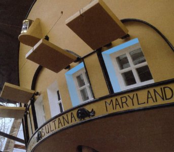

I had trouble with the square little windows it is clear square windows might of been used in the stern as you can see with the Sultana
like the Sir Edward Hawke the Sultana original drawing does not include a stern view so it is again made up a reconstruction
i have done construction work in my early days and i do know any a door or window has a header. The windows in a ships stern are set in framed on the sides with the stern timbers, sit on a sill or transom and they have a header tinted blue in the picture.
not all stern windows are square but they all have to be framed into the stern structure
