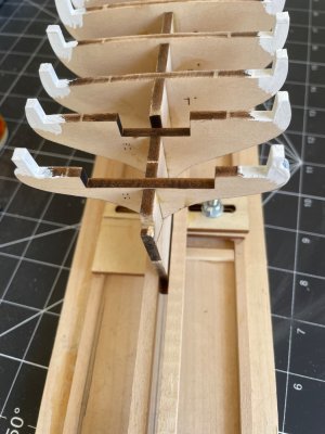

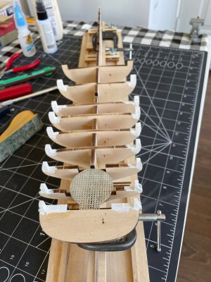

Good morning everyone. Sorry for not providing enough info. This is a model shipways boat and I find the instructions are very light compared to those of Billing’s for example.
My issue is forming the stern of this vessel. It appears I’m missing a critical piece to fit the stern . Here is a picture I’m trying to figure out. I have one more stern bulkhead to install but when I put it on the deck does not fit so next bulkhead fits in the deck slots. Can any of you come up with a solution to this problem.

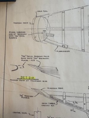

Hello Jackie and welcome aboard. That appears to be very reminiscent of how the stern of my Benjamin Latham schooner from Model Shipways went together.
The plans and instructions were somewhat vague as to how the transom was attached. Could you post a picture of your plans showing the stern section construction. I have included a picture of my plans for the stern section for comparison. You can see that on my plans I drew in lines so I could determine the angle of the transom.

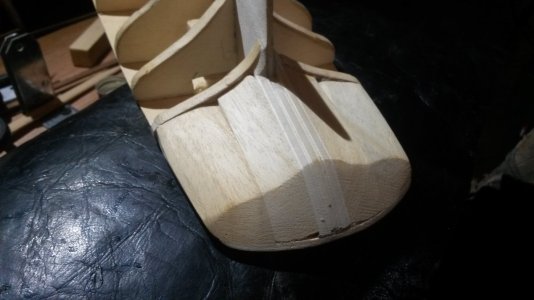

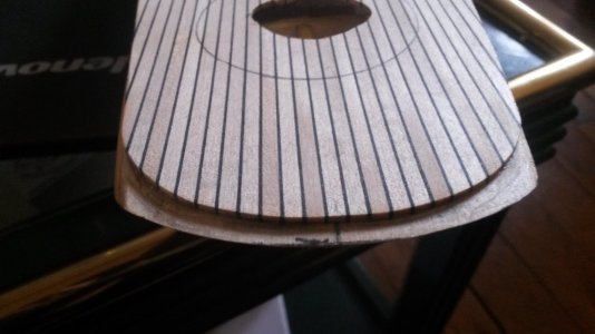

I reckon it's just a couple of blocks of softwood glued on and then shaped. You will need to find some decent plans, there are some available free on shipmodell.com and others. Make a false keel extension to add to the center line with the correct silhouette then add on to the sides. This is one i scratchbuilt on America for the 1891 version , which had been extended six feet in 1887, It's not exactly the same, but you get the idea. 20240425_085428.jpg
