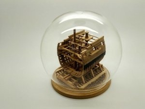

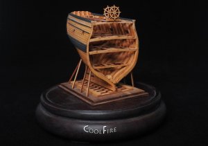

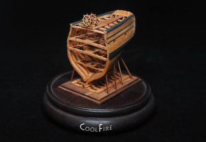

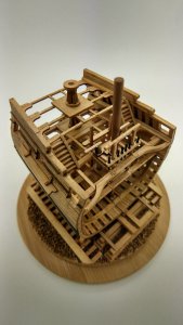

1/128 HMS Druid 1776 cross section
  • Thread starter Thread starter YiFan
  • Watchers Watchers 7
Apr 26, 2018
32
68

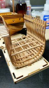

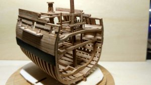

First of all, allow me to wrote the whole building wip in Chinese. you can also use Google to translated it.

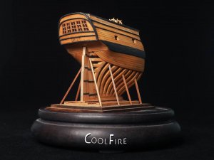

1/128德鲁伊截面是整个1/128德鲁伊计划的一部分。这个计划一共有四个部分,其中艉部截面已经由独角兽模型开发成商品发售了。看到由不少朋友们也通过了一些渠道购买到了。
那今天我给大家展示的是舯后部的制作过程。

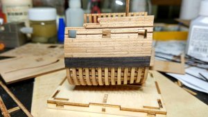

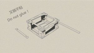

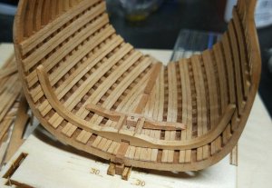

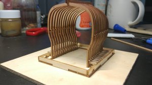

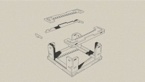

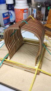

首先可以看一下舯部船台的设计跟艉部是不同的。这样设计是为间隔块的粘结更方便。

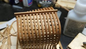

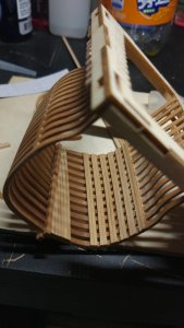

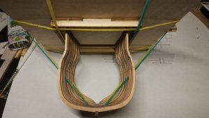

但是我拿到测试件的时候这个船台并没有做出来,所以我只能用基本的方式来做。也就是将肋骨倒装,用橡筋固定在模板上。
固定好肋骨龙骨以后,粘上间隔块
清除间隔块多余的部分后将外表面打磨光洁。

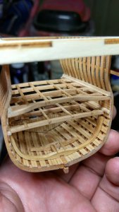

将内侧的炭黑也打磨掉,并整型,然后贴上内蒙皮。为了展现通透的效果,内蒙皮并没有贴满,而是采用间隔的方式。

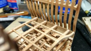

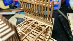

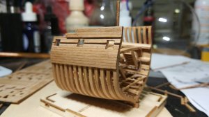

接着来

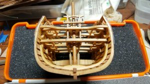

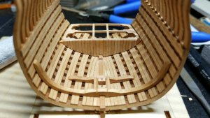

在肋骨靠近龙骨用锯子锯出排水渠

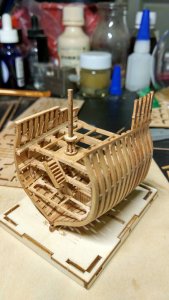

然后开始制作桅杆座及内龙骨等。

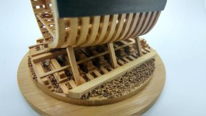

安装最底层的甲板和隔舱板
在内蒙皮上开槽并安装生活甲板
安装肘材和淌水条

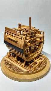

安装火炮甲板

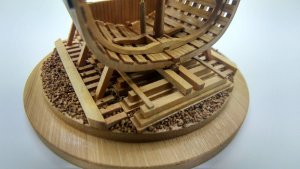

安装下层绞盘、楼梯。船舷上蒙皮定位并切除多余肋骨
接着干,船壳蒙皮,打钉,粘上扶手,开炮窗。
粘上加强筋(wale?)

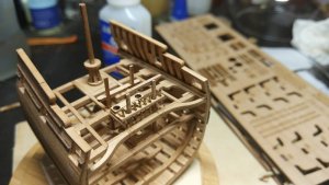

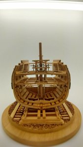

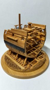

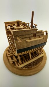

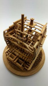

安装上层甲板,楼梯,绞盘,系揽栓,桅杆
安装侧支索承板

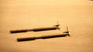

制作水泵及水泵手柄
将水泵安装到位

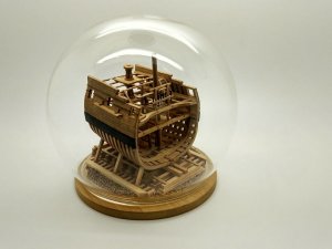

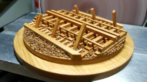

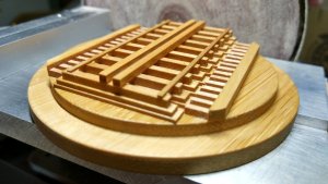

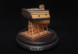

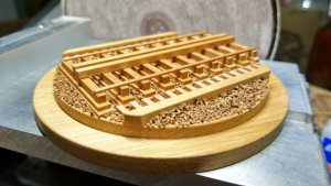

制作地台
The 1/128 Druid section is part of the entire 1/128 Druid plan. There are four parts to this plan, and the cross section of the crotch has been developed into a product from the unicorn model. I saw that many friends also bought through some channels.
What I showed you today is the production process at the back.
First of all, you can see that the design of the ankle stern is different from that of the stern. This design is more convenient for the bonding of the spacer blocks.
But when I got the test piece, the ship was not made, so I can only do it in the basic way. That is, the ribs are flipped and fixed on the template with rubber bands.
After cleaning the excess part of the spacer block, the outer surface is polished.
The inner carbon black is also polished and shaped, and then the inner skin is applied. In order to show the effect of transparency, the inner skin is not covered, but in a spaced manner.
Here is the log with English translate.
Happymodeling all
Greg

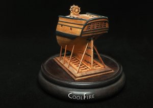

Hi YiFan,
Great to see more members from China on the blog.
I like the mid section very much, is it already available via Toabao?
Is the mid section starting where the rear section ends so you can combine them to one model?
Those models are Soooo nice.

Hi YiFan,
Thanks for your kind Maarten. I think I am in a new family now. the mid section will be on sale very soon.
Honestly, this is project was whole ship. and the hull divided into four parts. basically we can combine them up. But in order to have the best performance,you should build them together.
Would be great to make one display of sections.
I agree with you totally. Some weeks ago I found in the web photos of the living room from a modeler, who had three models in scale 1:48 of one french (ancre) model in display, a bow-section, one midship and one stern section - It was Looking great......
and in this small scale of 1:128 you can put these three models in one display cabinet..... would be really a very good project for in between a big size model
