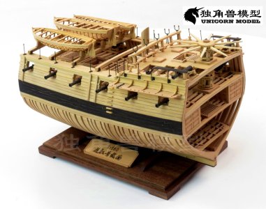

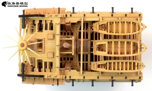

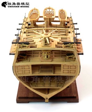

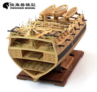

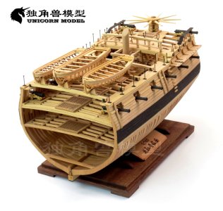

Hi guys, this is Unicorn Model and I bring you a new kit, a 1:160 midship cross-section model of the HMS Enterprise frigate designed by my colleagues. Perhaps some of you have already seen the stern cross-section of the Enterprise, which has a longer and more complex midship section compared to stern, and also carries three boats. Although it is miniature size, its details are remarkably rich, including every deck structure and cabins, as well as extremely tiny metal parts such as guns, hammock cranes, ladder stanchions, etc., there are many jigs in the kit, which are convenient for the making and fitting of small parts, but you must be very careful, because the parts are very weak and easy to break, This is a work that challenges one's own hands.

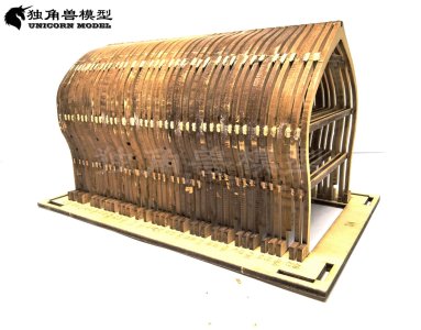

Günther Ship-1

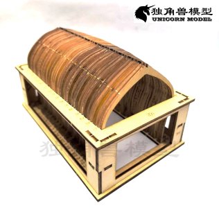

These are some images depicting the building of the Enterprise midship

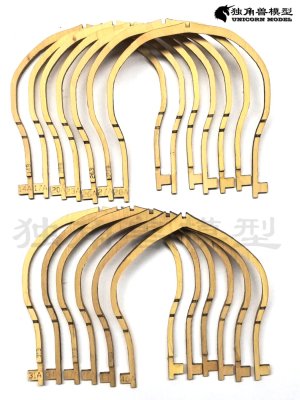

组装复合肋骨↑
Assembling of the double frames

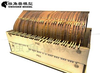

船体肋骨↑
The hull frames

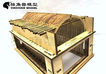

把肋骨逐个装上船台↑
The frames are being fitted to the building bert one by one
肋骨安装完毕↑
The frames have been fitted in place
安装龙骨↑
The keel is being fitted to the hull

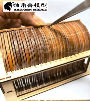

安装肋骨间隔条↑
The spacer strips are fitted between the frames
粘牢间隔条并切断船体外的多余部分↑
The spacer strips are glued firmly and cut off the excess parts outside the hull

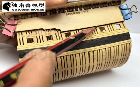

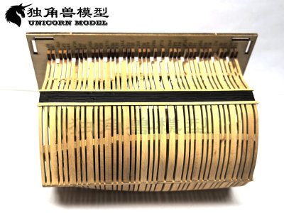

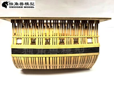

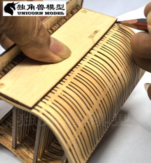

根据模板在船体上画出腰板的位置↑
The line for wales are being drawn on the hull according to the guidance of a template
安装腰板↑
The wales have been glued to the hull

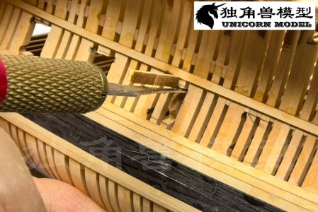

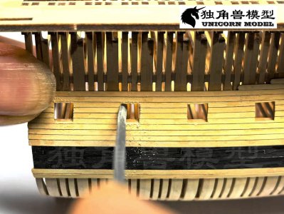

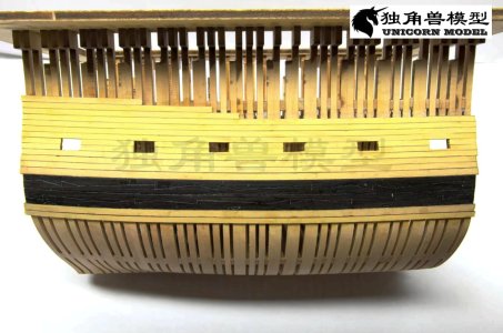

切割炮窗开口↑
The gunports are being cut out in the hull
安装炮窗衬板↑
The gunport linings have been fitted in place

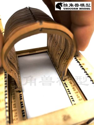

根据模板在船体上画出船舷轮廓线↑
The outlines of the ship's side is being drawn on the hull according to the guidance of the template

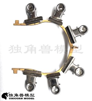

安装外船壳↑
The outer planks have been glued to the hull

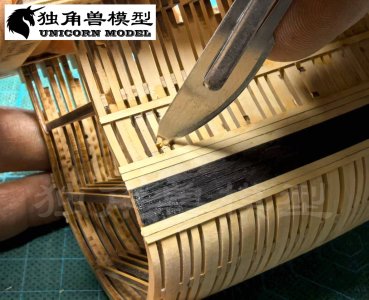

打磨炮窗↑
The gunport square is being filed finishing

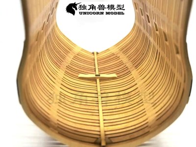

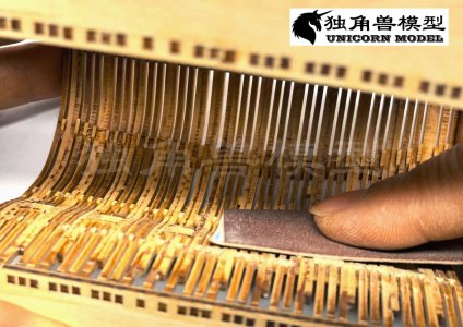

打磨内部船体↑
The internal hull is sanded down with sandpaper
安装内龙骨和主桅座↑
The keelson and mainmast step are glued in place
