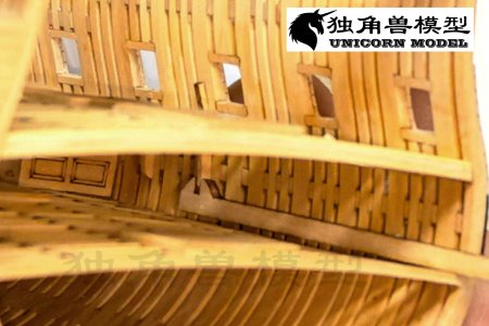

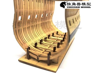

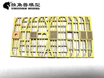

Hi guys, this is Unicorn Model and I bring you a new kit, a 1:160 midship cross-section model of the HMS Enterprise frigate designed by my colleagues. Perhaps some of you have already seen the stern cross-section of the Enterprise, which has a longer and more complex midship section compared to stern, and also carries three boats. Although it is miniature size, its details are remarkably rich, including every deck structure and cabins, as well as extremely tiny metal parts such as guns, hammock cranes, ladder stanchions, etc., there are many jigs in the kit, which are convenient for the making and fitting of small parts, but you must be very careful, because the parts are very weak and easy to break, This is a work that challenges one's own hands.
View attachment 540153View attachment 540154View attachment 540155

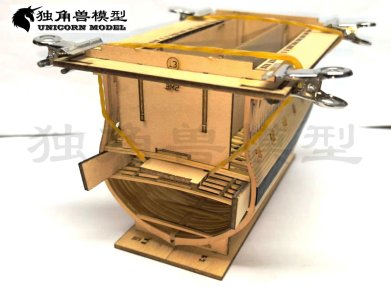

借助夹具定位和安装货仓甲板↑
The hold deck beams are located and glued in place according to the jig
将货仓甲板边缘磨成斜面以适合船体曲面↑
The both edges of the hold deck are being beveled to fit with the inner hull
借助定位夹具安装货仓甲板↑
The hold deck is being located and glued in place with the help of a jig

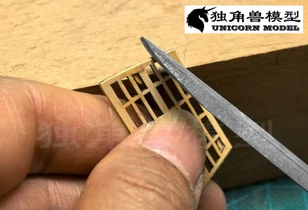

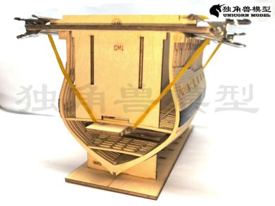

磨掉最下层甲板的炭黑↑
The black carbon on the orlop deck is being removed with a sandpaper block

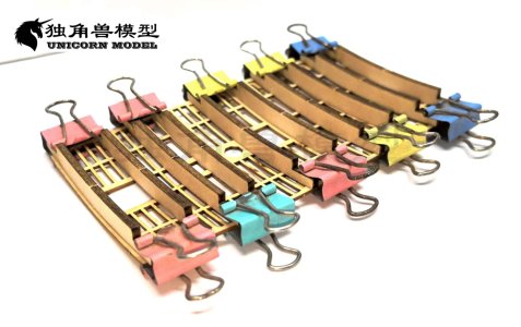

借助几个模板将最下层甲板定形为弧面↑
Several templates are clamped under the orlop deck to shape it into an arc surface
借助定位夹具安装最下层甲板↑
The orlop deck is being located and glued in place with the help of a jig

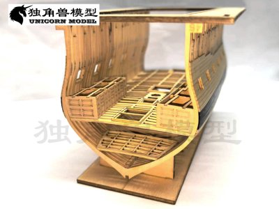

安装最下层甲板舱室↑
The cabins are glued on the orlop deck

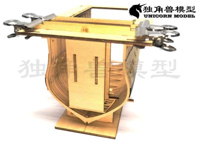

上层甲板↑
The upper deck
同样借助定位夹具安装最下层甲板↑
In the same way, the upper deck is being located and glued in place with the help of a jig

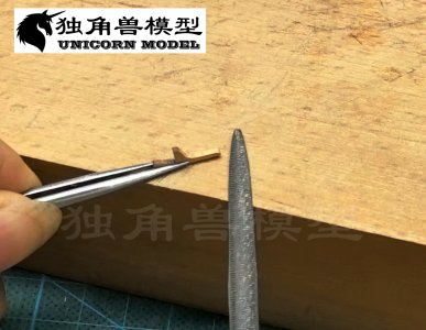

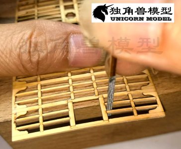

打磨竖梁肘材的炭黑↑
The carbon black on the hanging knee is being filed off
用一个特制工具调整竖梁肘材的位置↑
A special tool is used to adjust the hanging knees to vertically and then the knee is glued firmly to the hull

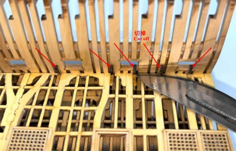

竖梁肘材安装到位后,用小刀把延伸段切掉↑
After the hanging knees are fitted in place, the extension sections of the knees are cut off with a knife
