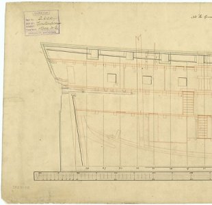

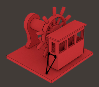

I noticed on earlier photos they had posted that they include a double wheel which would be very unusual for a 28. RMG drawings for Enterprise 1774 and the contemporary contract call for a single wheel. I double checked other contracts on larger vessels of the era to see if they specify double wheels when called for and those contracts are explicit in describing a double. Not a big deal, but for such a nice kit, I was surprised this was missed.

I hope I have understood correctly. You write that the steering wheel should not be double, but that it should only be a single steering wheel, right? Or do you want to check that?

Interesting point. The 1/48 MD instructions show it as a single.

Yes Gunther, you are correct. Sorry for not being clear. :( The contemporary drawing of her before she was relegated to being a receiving ship for impressed sailors and the original contract dated 16 July 1776 for her sister ship Aurora 1777 both indicate there was a single wheel, not a double on these 28s.
