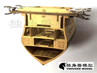

New kit 1:160 midship cross-section of the HMS Enterprise 1774

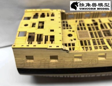

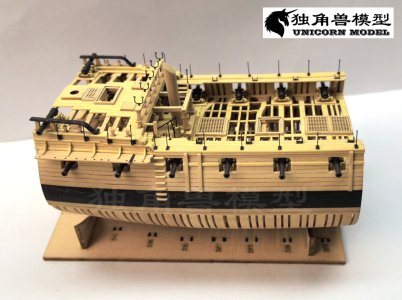

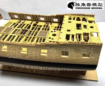

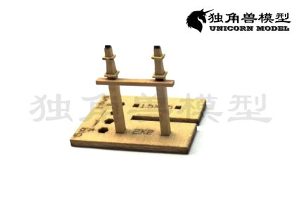

借助夹具制作主桅前后的系缆桩↑
The main topsail sheet bitts and main jeer-bitts are made in the jig

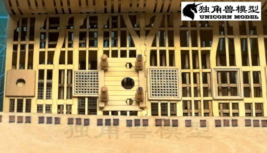

安装主桅孔加强版和两个系缆桩↑
The mainmast partner and two bitts are fitted in place
借助夹具定位并安装后甲板↑
The quarter deck is located according to the jig and glued firmly
安装后甲板的竖梁肘材↑
The lodging knees are glued in place

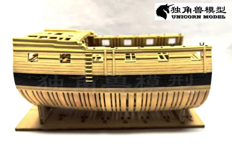

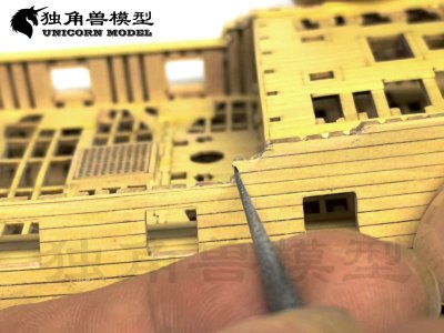

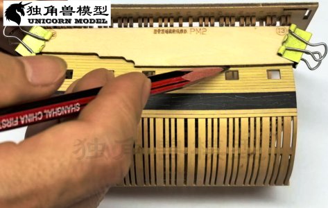

借助模板画出船舷轮廓线↑
According to the guidance of a template, the profile of the ship's side is drawn on the hull
裁断肋骨延长段并取出船体↑
The extension of the frames are cut off and the hull is taken out of the building bert

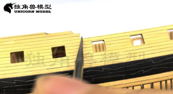

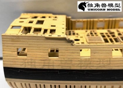

按线条将船舷打磨成形↑
The ship’s sides are shaped according to the profile line

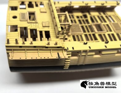

安装后甲板栏杆弯头和舷缘板↑
The drift rail volutes and planksheers are glued in place
安装甲板通道、后甲板栏杆花线和上、下护舷材↑
The gangboards, the quarterdeck dirft rail, the upper and lower sheer rails are glued in place
组装水泵筒体↑
The pump barrel is being assembled
安装水泵金属件↑
The metal parts are fitted to the pump barrel
将水泵装上甲板↑
Two pumps are fitted to the upper deck

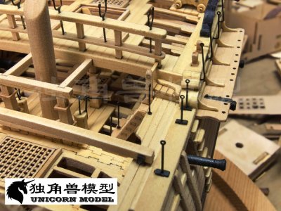

安装后甲板栏杆↑
The quarter deck breastrail has been fitted in place
安装侧支索承板↑
The channels are glued to the ship's sides

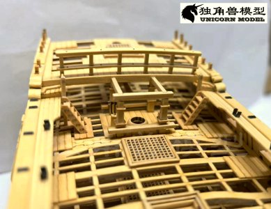

安装主桅和吊铺网架↑
The mainmast, the stanchions of the gangboard, the hammock cranes at the sides, the hammock crane at top of the breastrail, the gangboard ladder stanchions are fitted in place
组装火炮↑
The gun has been assembled
所有火炮就位↑
The guns have been in place

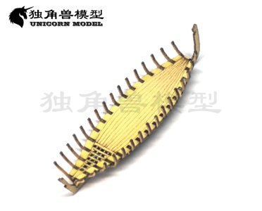

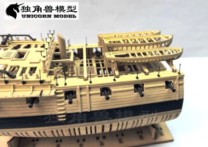

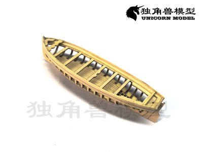

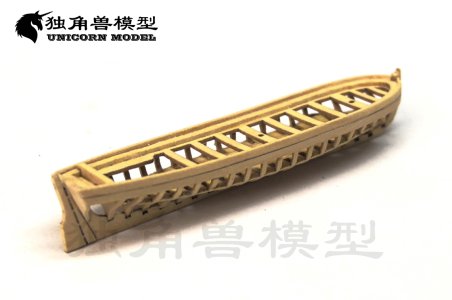

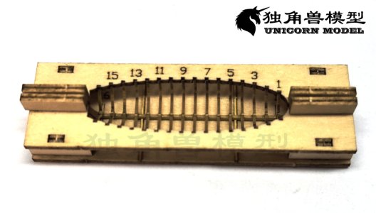

在船台上制作18英尺小艇↑
The hull of the 18-foot Cutter is being assembled in the building bert
安装小艇甲板↑
The deck is fitted to the hull
船载快艇完成↑
The Cutter has been completed
24英尺大艇↑
The 24-foot Launch
28英尺中艇↑
The 28-foot Pinnacle
3艘小艇就位↑
Three boats are placed on the corresponding crutches.

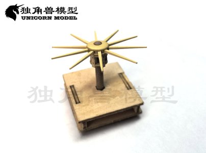

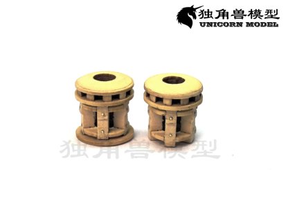

组装绞盘↑
The upper and lower capstans are assembled
绞盘安装到位↑
The capstan has been fitted in place

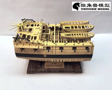

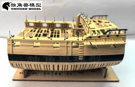

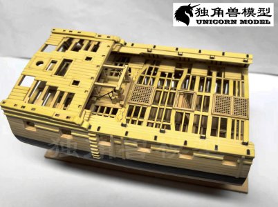

大功告成↑
Work completed
The open framing of the ship's boats is really nice to see, especially at this tiny scale. VERY impressive!
Is there a reason you used what look a lot like Commonwealth pattern guns (1650-1715) instead of Armstrong Frederick pattern guns (1760-1790) which would have been on the Enterprise 1774? At this tiny scale I am guessing few would notice, but it is just as easy to make the AF as it is to make the Commonwealth pattern. The missing chase astragal ring and button ring is what sort of jumped out.
No matter, it's great to see a fully framed model kit at such a small scale. Well done!
