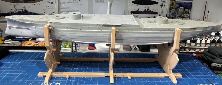

After way, way too long, and after having received an Andrew3D Swing Stand from my kids for Xmas, thought it may be time to actually make an effort and get back onto a build; so the dust has, literally, been blown off my Arizona.
Recap (not a lot, but a start):
  • Removed some moulded hull elements and replaced with PE (torpedo blister hatches, etc.)
  • Added 8 docking keels (from drawings and member advice)
  • Added torpedo blister strakes
  • Started a few sub-assemblies
  • Began modification of main anchor hawsepipes to better represent those on the actual ship
Next up - Finalise hull, prime and paint.....

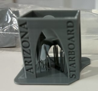

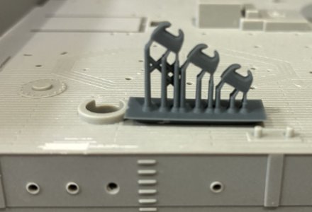

Got some nice 3D printed additions from MidWest Model Shop and Model Monkey to use in this next phase:
  • Port/STBD Propeller set (MWMS)
  • Correct style of fairlead (for top deck). (MM)
    • These have the channels to support placement of the degaussing cables in certain sections.
