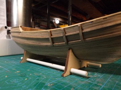

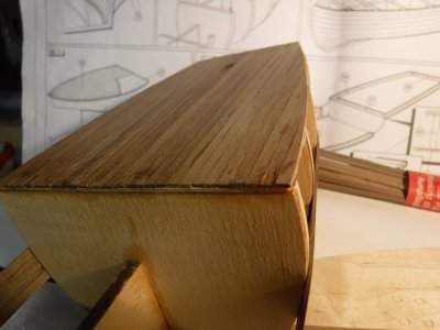

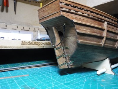

This a build log of my Amati Pinta. A model I began in 2019, completing the hull back then. Doing some deck fittings in 2020.

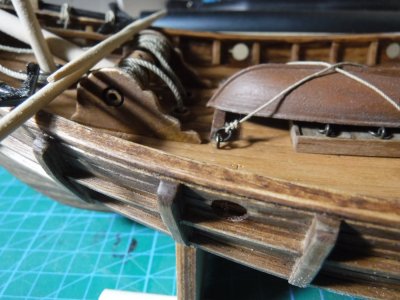

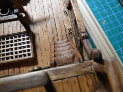

And I added the pump, windlass, bit blocks and anchors. Painted the metal ships boat brown, dry brushing it trying to make it look like wood, added the gratings, and stained what wasn't stained, while removing unwanted blotches from 2019.

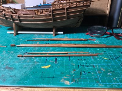

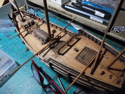

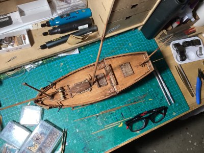

And this weekend I cut and tapered all the masts and spars. Using a bamboo skewer when I ran out of 4mm dowel. And ... I hand carved those "blobs" on the mast tops into blocks. You can see em laying on the deck, with the masts and spars I'm working on. Have to glue together some straight masts out of that stuff.
Then, I'm ready to add some deadeyes, step the masts and rig em down with the deadeyes ... and then set the spars, etc.
I ordered a sewn sail set, from HiSModel. Expecting that in a few weeks.

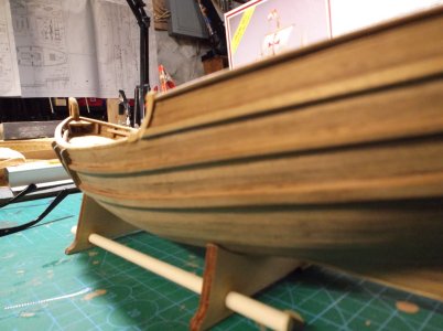

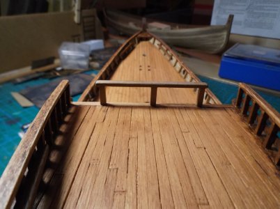

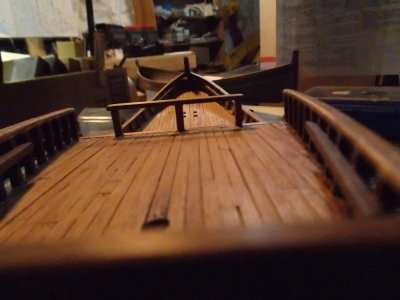

So, I'll begin with some pics from 2019, then quickly bring it up to date. First, a couple of pics, as it is today.

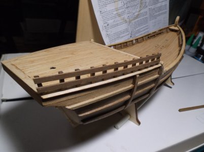

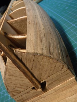

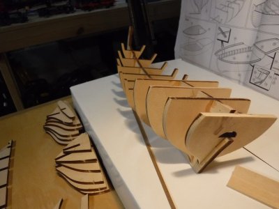

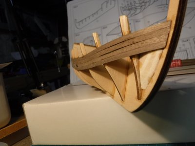

And now I'll see if I can't sort out the earlier build pics (many from 2019), into something coherent.

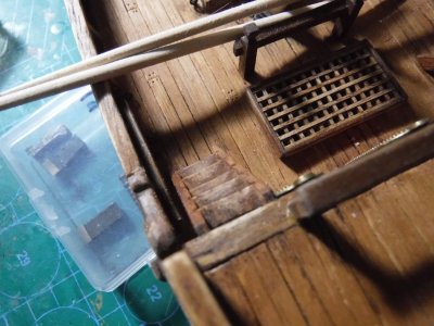

Just finished gluing the 3 handcarved blocks to the 3 masts. This pic shows em loosely stepped into the hull. I'll either paint the cannons next, or start on the standing rigging - and get those 3 masts set properly, or assemble the spars.

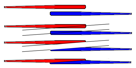

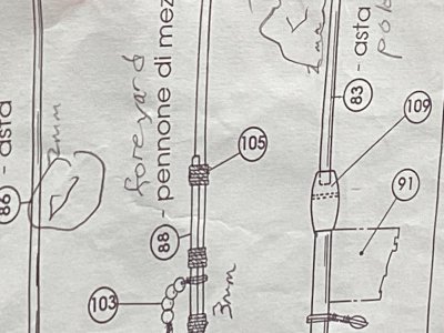

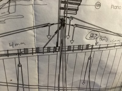

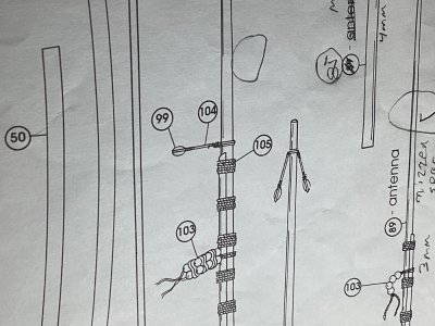

Looking for advice ... regarding tying two spars together to make one larger spar ...
  • do you just tie them together?
  • or carve out the ends a bit, for a good fit, before tying them together?
My instructions do not say, but the plans (see below) suggest this is being done. When I look at the ends of the spars, they are drawn seemingly overlapping the midsection of the spar they mate up with, as if they were hallowed out a bit ...

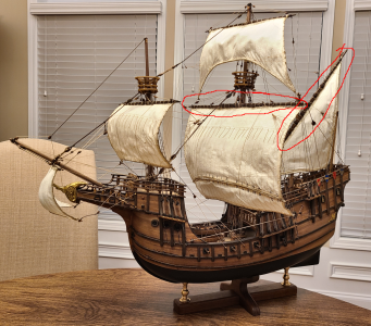

No need to get fancy. This is how I did mine:
You basically take two identical pieces, overlap them and sand off at the cut lines, leaving a bit of stock at the ends. You then have two flat surfaces to glue together - they go together quite nicely. After gluing, you wrap them with rope, etc. Here's mine, although it's hard to see:
Thx. I like that method. Nice lookin model, BTW.

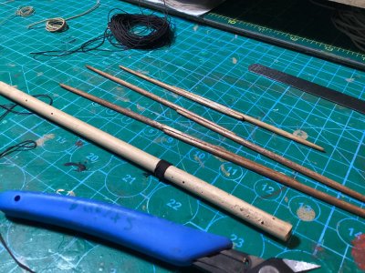

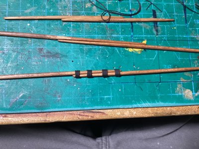

Here's the results. I used the grinding identical flats on both spars and gluing the flats together method recommended above.

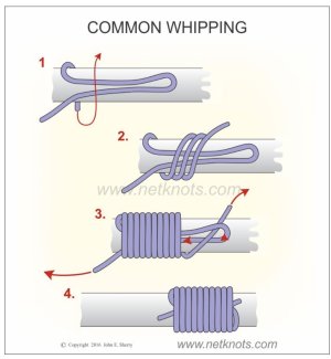

Also shown is a thicker dowel, on which I tied my first "common whipping" knot. And this is how I'll "tie" the (already glued) spars together.
The common whipping, courtesy of netknots ...
Never used this before. Dunno why, because it works ... snugs up without having to fix it with a spot of glue. Been faking my whippings up to now.
