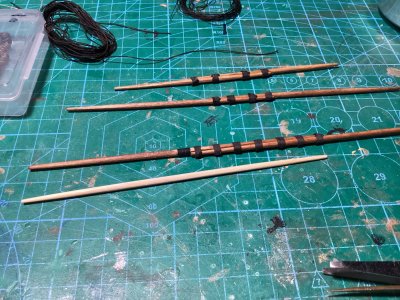

I finished the whipping on all 3 spars.
However, one of my two main spars broke near the middle while I was sanding it to shape . (Dowel rods don't normally snap.) So, I but glued it back together. Basically, a butt joint. But it broke two more times, while I was adding the whipping to that set of spars.
Solution?
Here you can see the extra whipping, with thinner rope, over the break. I also soaked some Titebond into it.
I just shoulda removed the whippings, separated the unbroken spar from its broken mate, and redid it with a new spar. But I'm so lazy.
Anyway ... if it breaks again, you can see the new spar I already carved (from a bamboo cooking skewer - was on hand, was the right dia 4mm) ... ready to go.
I imagine that some splints woulda been helpful.
