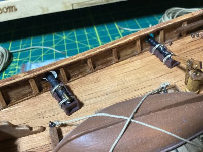

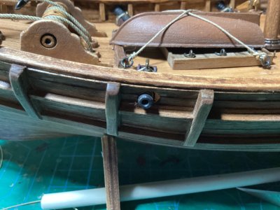

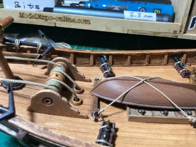

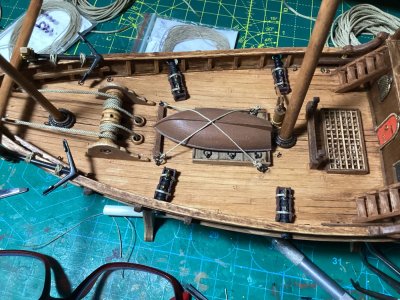

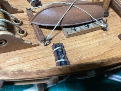

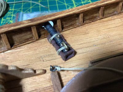

How the cannon look today ...
  • Used matte black on the barrels.
  • Tied em to the carriages with some rope.
  • Bored out the barrels.
  • Left the lifting/moving HW on top naked brass. (just for fun - IOW historical accuracy was sacrificed for, whatever)
  • Carriages painted a flat color called hull red.
One broke in half (not surprised as it had cracks), so I used CA to glue it back together. (best not to fire that one)
Above, showing one of the bores I drilled out. Was worth the effort.
You can also see the gunwale not centered on the bulwarks ... this was my first hull, done 7 years ago. Blame it on the shipyard.

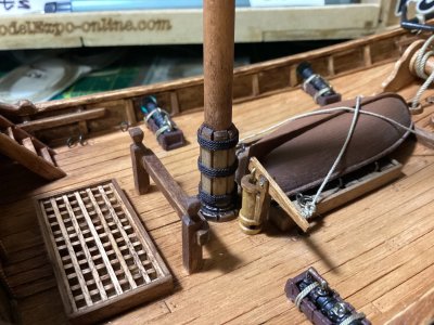

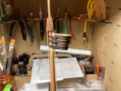

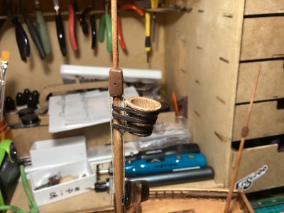

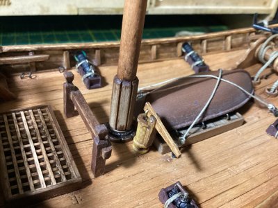

Weather stained at the tops of the mast support boards, where the water running down the mast would be seeping in. And some at the bottom, where the water would collect, and seep upward.

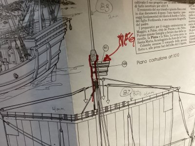

Finished the crows nest. I put a bit of wood between it and the mast, so that the main spar lifting halyard wouldnt bind on the block and the upper lip of the crows nest. As it does when the crows nest is mounted directly to the mast per instructions.
The instructions, showing the crows nest mounted directly to the mast, with the crude red marks showing the true rope run from what the instructions show ...
The retired engineer in me, insisted, on a non binding halyard.

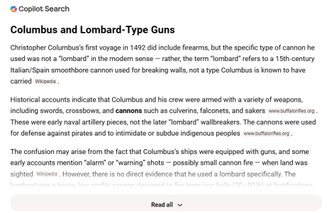

Thx. And yeah, I'd have to agree, as I've read as much myself - OTOH, a quick search for "Columbus and Lombard type guns" provided this ...
Making it all very interesting. What type of gun(s) he had? I don't have an opinion on that - not enough evidence for me on that.
However, it's common sense that he would have had the latest tech on board - navigation, sails, food storage, medical and military - all the latest gadgets (same as we'd do). And they did have guns at that time - so yeah, Columbus carried something that fired rounds, on his trips. Maybe a lombard.

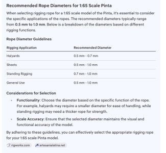

My kit has no rope diameters. So, I searched on "1:65 scale Pinta rope diameters", and came up with the Artesania Latina instructions ... which provided rope diameters for all rigging. And wow, those instructions were just so much better than the crap I got with this Amati kit. OMG what a difference. Wonder if Amati has improved their stuff, as I got this kit about 20 years ago.
I also got this table ...
However, the Artesania Latina kit has the anchor line at 1.5mm, the shrouds and stays at 0.5mm, and everything else smaller. A lot of 0.15mm dia roping.
So, I plan to scale to keep sizes relative, while also maximising the view ... so that one thinks they are seeing roping, and not a bunch of very tiny threads.

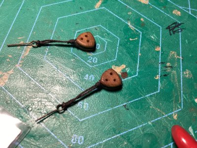

I do not like working 1:65 scale. Especially the rigging. My first two mainmast shroud blocks, ready to pin to the deck. Took me about an hour to make the 1st - working out how I wanted to do it. About 45m for the 2nd. Geeze!
The ropes are spliced (with CA-) on the tops of the blocks. First, I looped some 0.4mm rope through itself around the ring, pulled it taut, and secured it with a tat of CA-. Then I seized it with 0.15 rope, using common whipping, moved the seizing into position, pulled it tight, and secured it with a tat of CA-. Snipped off the two ends. And finally, wrapped the two remaining ends of the 0.4mm rope sticking out past the seizing, around the triangular block - using CA- to splice the rope at the top of the block. For the splice, I laid both ropes into the groove on top of the block, applied CA-, then sliced off the extra with my xacto blade. To make it look like a tightly spliced rope there.

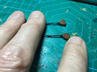

And here's why 1:65 scale is my least favorite to model in ... the sheer impossibility, of these fingers, seizing and tying up these tiny ropes, into something presentable ... and yeah, of course, I've always got two tweezers on hand.
If/when I ever finish this ... and I have dropped the Pinta 2x before ... I will stick to 1:48 or larger scale ... 1:30 and 1:24.

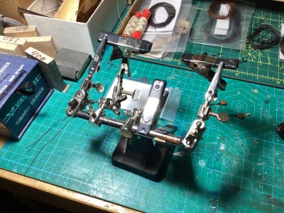

I did order a better helping hand ... this was $26 at Amazon. It should decrease my frustration a bit.
Compared to what I've been using for years now. Nothing stays put.
Maybe it will help, a bit.

Good morning Tim. I share your pain. Non the less those 2 shroud blocks look awesome . Very cool “helping “ hand you bought.
Cheers Grant

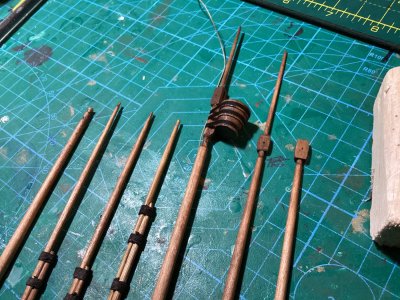

Well, the standing rigging is finally underway.
  • The 6 mainmast deckside deadeyes are pinned to the deck.
  • And I notched the masts and spars where the ropes hang from them. The bowsprit has 2 notches. The outer one for the mainstay and the inner notch for the 2 sheet blocks.

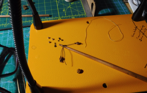

And, a comment on my newly acquired helping hand ... it helps. It let me finish those deadeyes in 1/3 the time. Having 4 equally usable clips is a blessing. So much more useful than my previous rig.

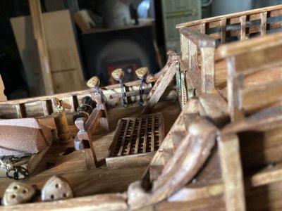

A couple pics ...
I looked into bowsprit mtg methods (no pic or dwg of that was provided with the kit). And realized that lashing the fat (uncut) rear end of the bowsprit to the base of the formast centers the tip of the bowsprit. Which is perfect alignment for the forstay. The bowsprit will be cocked a bit, IOW.
So, now I wonder how much the mainstay will rub against the formast? Maybe I can tie the mainstay off to one side of the tip of the keel stem, so it hardly rubs the formast. And maybe, it simply doesn't matter.

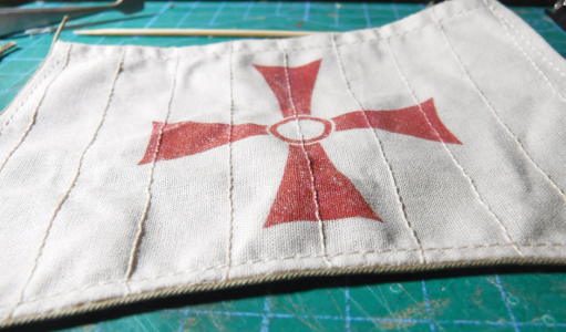

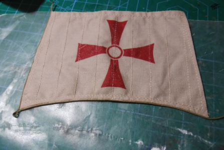

Got my new sails, the Pinta 1:65, Amati - set of sails with printing - HiSModel a few days ago. Found I had to treat em more gently than my last 1:24 scale set of sails I worked with - the 1:65 sails are more fragile - and I had to not weather the 1:65 sails by wrinkling them up repeatedly as I did with the 1:24 sails. Instead, I soaked these 1:65 sails in tea. That dimmed their whiteness, and wrinkled em nicely.

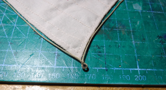

Here's a closeup of the foresail, with some roping I attached earlier today ...
To glue rope to sail ... I put a bead of Lineco PVA on the edge of the sail, place it on wax paper and press the rope into the edge of the sail. It tacks up right away. And it's flexible after drying.
Here's the foresail and thimbled roping, before gluing
And the foresail after gluing the rope to it ... on some wax paper
As you can see from the glue marks on the wax paper in the above picture, the work has been moved 2x already, in order to free it from the excess glue that found its way to the wax paper.

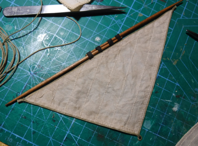

The mizzen sail, with all edge roping applied, laying next to its mizzen boom. I extended the roping along the boom a bit. For lashing to the boom.

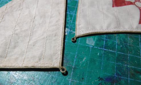

All the sail corners that don't abut a spar get thimbles - showing the mizzen and fore sails ...
Also been adding sheet blocks to the bowsprit
Cheers.
And oh yeah - been thinking about also stitching the roping to the sails - to improve the cachet. But all I know is it might be called a "blanket" stitch if using a sewing machine. We have a sewing machine - never been used. Least 20 years old.
