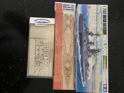

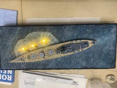

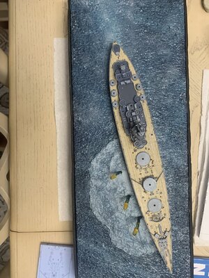

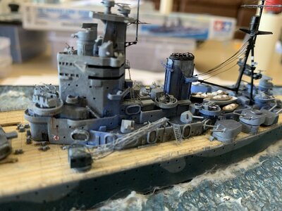

Just starting a group build through my IPMS group. The requirement is for each of us to choose and complete a 1/700 scale ship by mid-March. I chose the Nelson due to its unique design. I plan to enhance the kit with an Artwox wooden deck, anchor chain, WEM PE set and scratch building. I have also found PE crew to place around the ship. I’m expecting it to arrive shortly.
I’m going for an action diorama during Operation Neptune,when she relieved her sister ship, Rodney during the Normandy Invasion. This will be my first try at dazzle camouflage not to mention working in 1:700 scale and using photoetch. I may go blind, bezerk or both! image.jpg

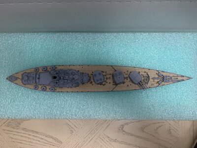

I have just received a book from Shipcraft called ‘Rodney and Nelson’. Hopefully I will glean some useful information from it to better detail
This kit as, although nicely detailed, it could use a little more, especially on the suprerstructure

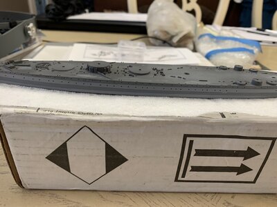

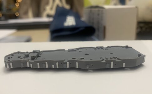

I am toying with ways to accurately scribe hull plating also. Not sure how to go about it as yet.

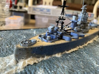

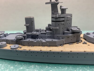

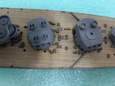

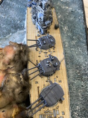

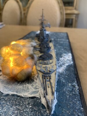

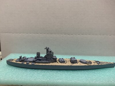

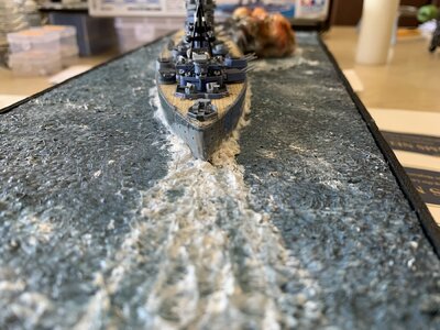

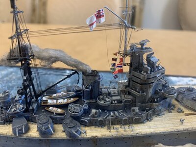

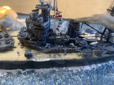

Thank you Uwek. I have been putting the final touches on the kit. Although sparse, here are some pictures of my build. I need to come up with a way to more accurately photo-document my builds. There’s quite a few bit of scratch build. Particularly in the masts and ventilation systems. The rigging was done with easy line and some fly-tying threads. Made all of the flags myself. By no means is this my best work. I’ve never worked in this scale before.
