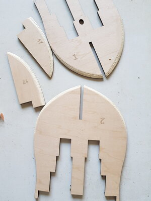

First thing has been to make a full inventory of the 2 boxes, using the part list below.
You can find a very complete list and pictures of all the components available in the box in the very thorough post from Dematosdg that can be found here.
All looks complete, let’s get started!!!

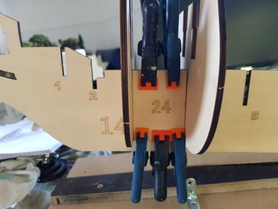

Attached the 2 parts of the keel and joined them with item 24 on each side to strengthen the keel. I pre-inserted bulkhead 3 and 4 in order to make sure they will fit in nicely.

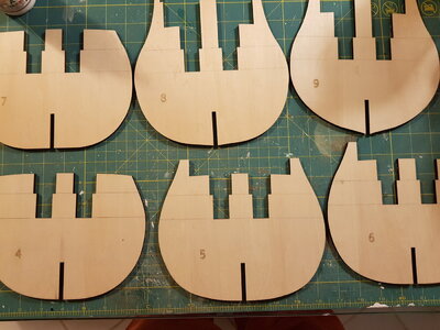

I penciled each bulkhead with the position of the decks. This may be useful later on.
I have filed the front of the first 2 bulkheads in order to have an easier adjust of the planks.

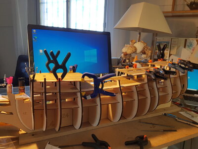

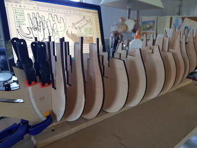

Glued all the bulkheads. The interfaces on the keel are sometimes a bit narrow and have to be slightly filed to easily fit.

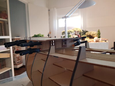

I pre-constructed the bulkhead at the stern but found out afterwards that it may be was not the best idea in order to install this last bulkhead.
Now the full skeleton.

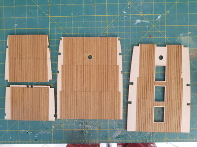

Now ready to insert the lower deck.

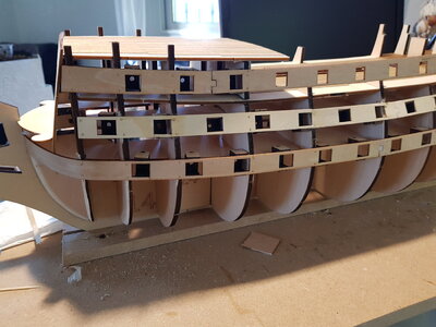

Good progress since my last post on Sunday.

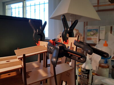

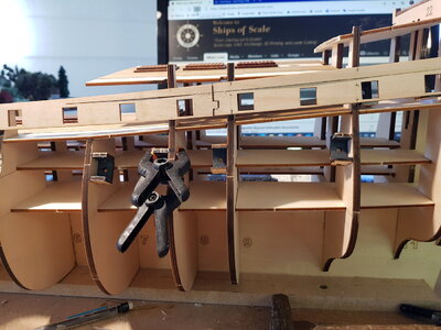

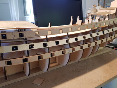

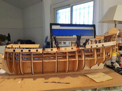

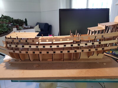

The issue I had aligning the stern has been solved and both stern and bow have been installed
Installed all the canon boxes and mounted the 3 layers of portholes on one side(not sure about the name in English :oops: - it's called "sabord" in French and Google translate gives me porthole as translation).
I glued the canon boxes vertically rather than horizontally (documented in the instructions). They do not fit with the bulkheads otherwise.
Started the same on the other side, but still some work to do here.
This will be for tomorrow.
