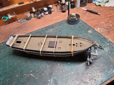

Got the bulwarks grimed in and the lower hull glued and drying. Once I place the deck in, I'll glue the bow and stern closed, but I need to leave it loose to fit the deck and the contour of the hull will not let you fit the deck if you glue the hull filly together.

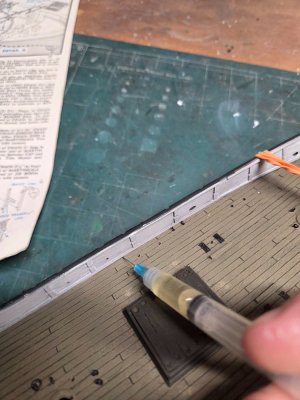

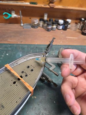

I must have 5 pounds of clamping pressure on the bow stem in order to get it set right. I've used testors tube cement followed by liquid cement to enforce the glue into the voids. For the deck I use a small gauge needle to carefully put glue along the seam where the deck meets the hull. This will dry for 48 hours before I remove the clamps and rubber bands. The stern met together nicely, I won't have must work to hide the seam.

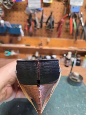

Hull glue is dry, now I'll be sanding, filing and filling the copper plates to reshape and taper on the bow and stern. You can't see the keel, but I'll still sand and fill with putty, it's the neatness in me.
