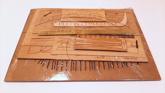

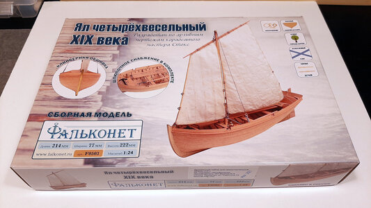

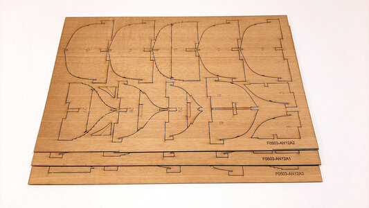

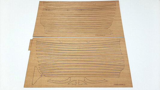

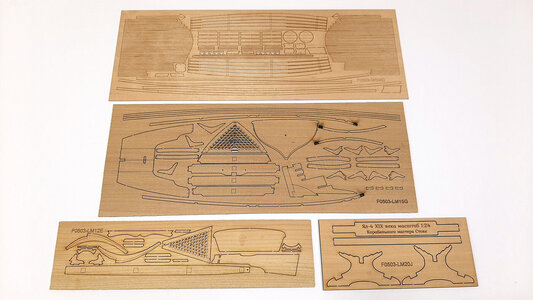

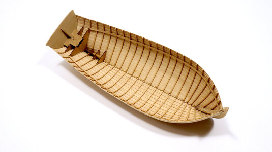

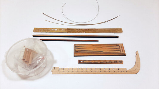

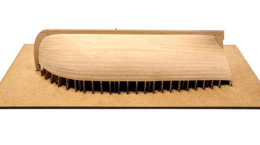

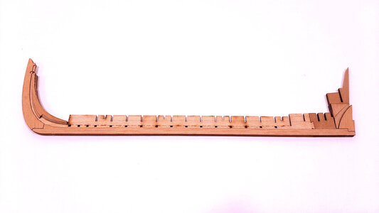

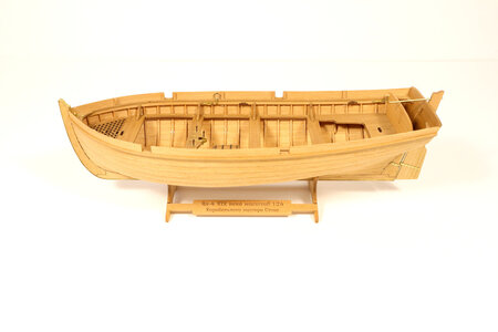

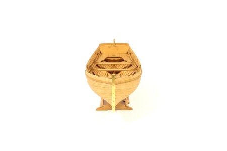

Hello everyone,
I once again shoved my other builds aside for an easy to build kit. I bought the Falkonet Viking ship last fall and had a lot of fun building it. I cruised through that kit in about 3 weeks. I have a feeling this kit will be the same but will take a little longer. Sometimes I just want something straightforward to build.

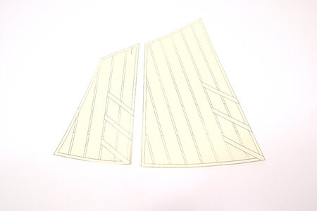

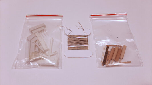

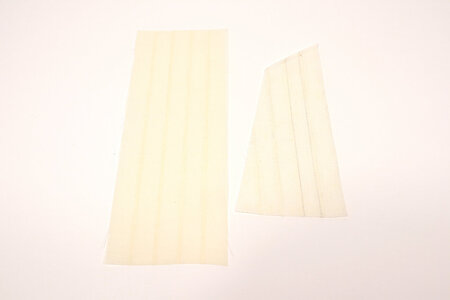

The Rope will be replaced of course, though it is some of the better kit stuff I've seen. The sail material is very fine cloth but there is hardly enough. I am looking into pre-maid sail options. If I am brave enough I may try making my own.
Yawl 1.jpgYawl 2.jpgYawl 3.jpgYawl 4.jpgYawl 5.jpgYawl 6.jpgYawl 7.jpgYawl 8.jpgYawl 9.jpgYawl 11.jpgYawl 12.jpg

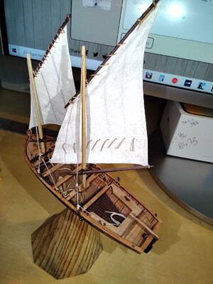

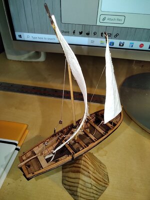

Hi Ben

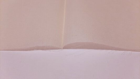

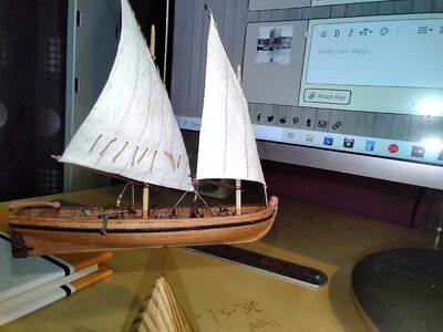

I built this little 1/64 Yawl from VM Models while waiting for some bits.IMG_20220328_172645.jpgIMG_20220328_172755.jpgIMG_20220328_172513.jpg
I used silkspan, painted with w/b acrylic and stitching lines made with a 2h pencil.
Maybe of interest, Yawls in here in Ireland are nearly always double ended.

I've been putting all of my modeling to the side lately. I want to get back to this little kit, I almost have one side planked... feels like I only glue one or two planks a week. I like the silkspan sails idea, I will have to try it out at the very least.

The beauty of silkspan is that even after you have painted it and marked it with a pencil when you
spray it with water it will turn into a very manipulatable fabric which will, when dry, keep it's adjusted shape.

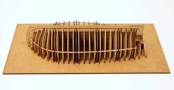

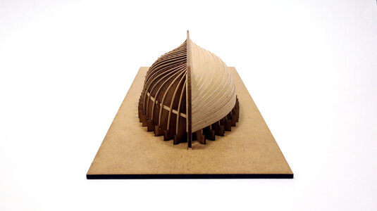

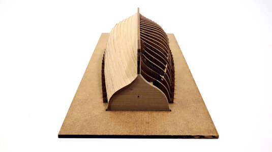

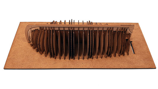

I managed to glue one side of the planks on. I gave up on using PVA very early realizing it was difficult and time-consuming even with CA glue at tough spots. Using just CA glue the job was easy and I finished most of the planking in one night. Now I need to carefully clean up the glue stains.

Hello Ben, great progress, very clean accurate job. I build this kit a few years back

Good afternoon Ben. Excellent planking. It is a good looking model to build. Cheers Grant

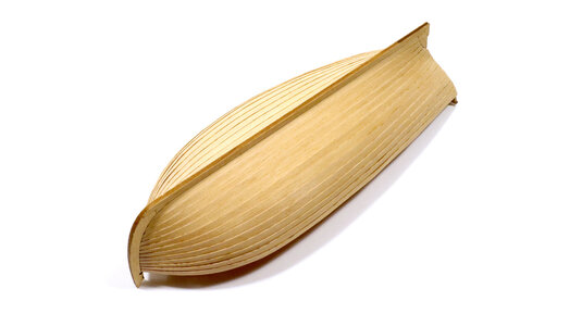

The planking is done and the hull is off the planking jig. Somehow I managed to glue some of the jig onto the hull but it eventually all came loose. Now it might be time for some wipe-on poly!
I think I'm getting the hang of my new camera. The photo editing software that came with the camera was also really decent. It's easy to white balance and sharpen up the images.
