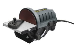

I have a Byrnes disk sander, and it is a remarkable tool. I love it!!! But I hate changing paper back and forth for different tasks. The bulk of my work with the Byrnes is with the fine grit (180). I occasionally could use coarser grit, like 100. I decided to make life easier by buying a bench top sander that I can equip with coarse paper. It cost me $40 at our local Menard's. The tilting table mechanism and miter gauge are cheap, but I simply set both at 90 degrees with a try square and I don't anticipate changing them often. The best feature is a variable speed control. Wonderful!! I really wish we could have that on a Byrnes!

Dave, we have this on Proxxon!!! :p I also suggested this sander to Don (@donfarr), Unfortunately, he mentioned an unpleasant experience with the tool, He had a hard time mounting it steady. How heavy this tool and is there a mounting hardware\bracket with it? Proxxon comes with the mounting tool.

Jim: The sander is light, but it does have a clamping mechanism that can clamp it to a tabletop as thick as 2-3/4" thick!

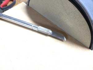

I have the Proxxon and personally don't care for this particular tool. Have many other Proxxon items and they have been good. The problem is the space between the adjustable table and the sand paper. It's fine for larger items but very small scale items are difficult to maintain accuracy. Although, maybe it's jut me!!!!

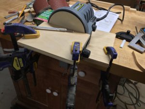

I just measured it: The distance between the sanding disk and the edge of the table is about 3/32" (1/32" or a little less on a Byrnes). If that space is too wide for you, clamp a piece of plywood to the table, butted up against the sandpaper face. Use two clamps, one each on the Turn on the sander: VOILA! Zero-clearance sander.

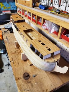

I've owned one of these sanders for over a year now and have used it in building my wooden model ships. No complaints here. Yes, comes with clamps and has an exhaust port for hooking up a vacuum to. I use it in the house and the wife remarks that she doesn't see any wood dust anywhere.

I had this sander but could never get it to stay mounted, the clamp kept falling off, I did like the varible speed HOW DID YOU KEEP IT MOUNTED, I need a disk sander badly basiclly for sanding joints persicely was going to get the model expo one, but looking at what you guys say rethinking this as I am going to menards this SATURDAY if you guys can tell me how you mounted it i will get it again, ALSO while on the topic WHEN SANDING THE JOINTS FOR FUTTOCKS DO YOU USE A PROTRACTOR ON THE PLANS TO GET THE CORRECT ANGLE OR DO YOU DO IT BY SIGHT, ANY HELP WILL BE GREATLY APPRECIATED. Don
