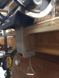

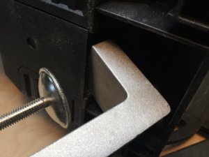

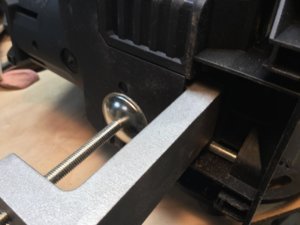

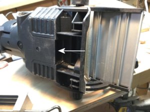

Don: You should be able to clamp the sander to any table top up to about 2-3/4" thick! Here's a series of photos. The first one is the clamp itself. It has a bend in it to form a right angle piece that attaches to the sander (white arrow). The second photo shows the bottom of the sander and the slot that the right angle bend fits into (white arrow). The next photos are a series showing how the clamp attaches. Tighten it down and you're good to go! Hope this helps.
As far as using the sander, I just leave the paper template in place, cut the joints long and sand by eyeball to the line. No protractor needed!sand1.jpgsand2.jpgsand3.jpgsand4.jpgsand6.jpg

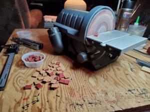

Donfarr, if you mean the 5" disk sander from my pevious posts, I do not mount it. I do not need to have it mounted. I keep it portable moving it constantly artound my crowded and small working desk. Small items I sand - no need to have it mounted. By the way I got a work bench clamp with it but I never used it.

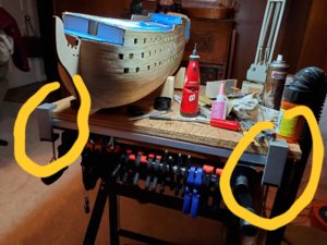

Hi all, I finally got the 5 inch disk sander from MENARDS, $39.00 and this time I read the instructions (THANKS DOC) it is clamed in place will show a picture tomorrow, another thing I like about it besides the price is the size with my hobby room getting more and more cramped it fits in nicely, and you can see what a difference it makes in the joints of my Le Rochefort. Don

I just got mine this PAST SATURDAY, it was the second one i bought as I DID NOT READ THE INSTRUCTIONS AND HAD IT MOUNTED THE WRONG WAY THANKS TO DOC BLAKE I GOT ANOTHER ONE AND ITWORKS LIKE A CHARM SMALL AND COMPACT LIGHTWEIGHT AND VARIABLE SPEED JUST LOVE IT. Don PS MOTTO JUST READ THE INSTRUCTIONS

I missed the 11% sale, but used up all my rebate forms, so I got it for $3.34. Set her up and she runs just fine. Perfect for the model room. Hooked her up to the vacuum attachment. Seems to catch almost all the dust. And - I really do like the variable speed. It can be slowed down to sand plastic without melting it into a blob.
