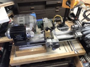

The Sherline, Taig and Unimat are all good small machines. I have the Taig that I purchased on Craig’s list for $200 with all the add ons for the lathe. Unimat is now a collectors item and are very expensive. The Sherline is the best of them but you seldom see used ones for sale. Keep in mind the tooling will end up costing all most as much as the lathe.

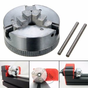

Just a generic 4 jaw chuck, Ali express also ebay. It was on the same page as the various tailstocks. With this stuff there's no information so buying is a risk either way. Doesn't give any clues whether it's threaded or push fit. But I still don't know how to remove the supplied drill chuck. If I can remove it I'll have a better idea of what might fit.

That chuck on the picture is for the Unimat 1 and has an M10 thread from memory. The Chinese copies might have the same connection.

Thanks. That's not going to work. I did once see a bead lathe (the same sort) on ebay which had a 3 jaw chuck. So somewhere there is one that is designed for it. A 6mm chuck would be more useful than the 4 fitted.

BUT: Be careul, this is not a common M10 thread, but a M10 x 0.25 as I remember. So dont try to use it with a M1 x 1 Chuck! Unimat does have the full metal set too, with all necessary parts including a 4-jaw chuck https://www.thecooltool.com/zubehoer/ml/

Thanks Gerhard. That one appears to be M12 x 1. If I can get a thread reducer, say an M10 that will fit one of the ebay items I can use the existing chuck to drive it. An M6 to M10 would do because I can mill off the threads to fit the drill chuck. Now I have to trawl the net although I have a marine engineer mate can make one, he's currently on lockdown in Liverpool so should have plenty of time on board. I'll put this thread on watch so I can post the results.
