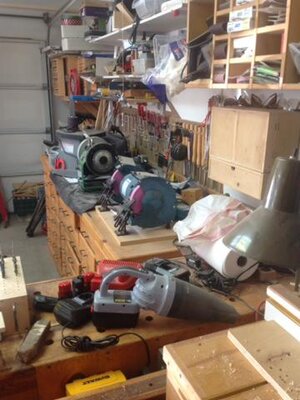

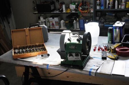

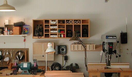

The choice of abrasives will make a difference. I use pink wheels on my 8" grinder (Norton) as they are semi-friable. Wobble and vibration is very dependent on setup and wheel balancing. But...I mainly use a Tormek for my turning tools. The stone turns only at 90 RPM and is in a water bath - the tools do not get burnt which would remove the temper. And the Tormek employs different jigs for the many different edge configurations. Baldor makes great motors but you will pay more for them. IMG_1959.JPGIMG_1480.JPG20200628_181330.jpg
