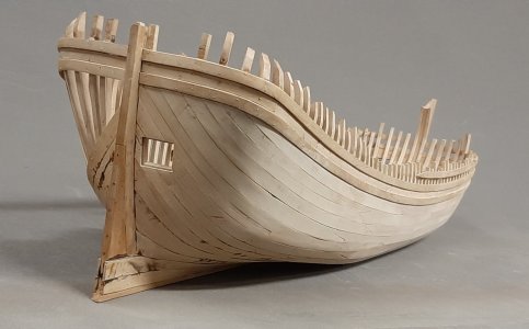

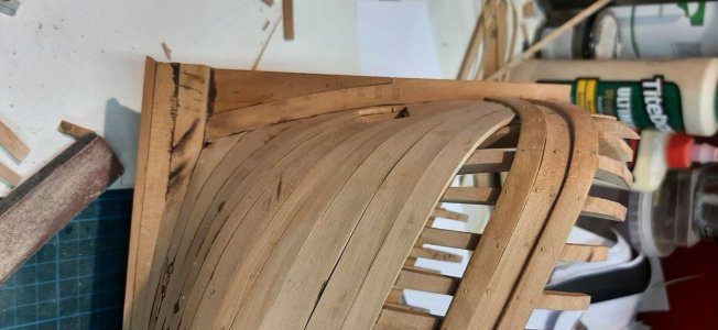

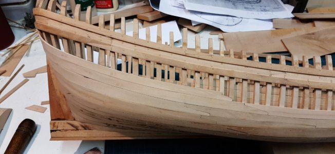

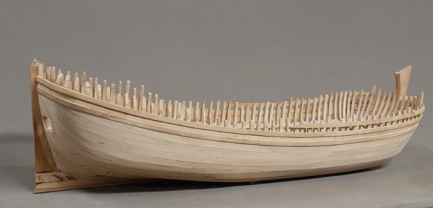

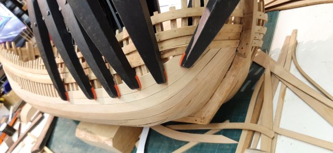

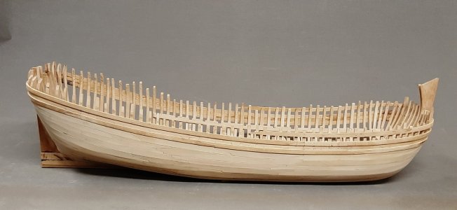

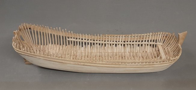

Slow progress on the fluyt due to too much other obligations, but the hull planking below the wales is coming to an end.
In the stern still 2 planks to go.
In the bow still one plank to go.
In the mid section the next plank will connect with one plank from the bow and two from the stern, this to create a plank with an even width to close the hull planking below the lower wale.
Hopefully I can finalize that somewhere in the coming week.

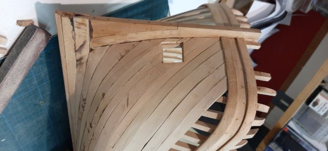

View attachment 556947View attachment 556948View attachment 556949

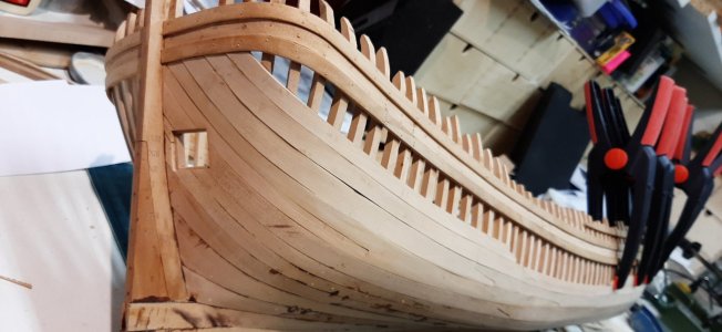

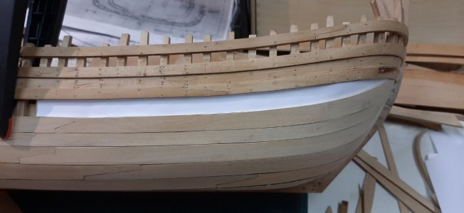

Slow progress = progress! That’s looking very nice and authentic, Maarten.
