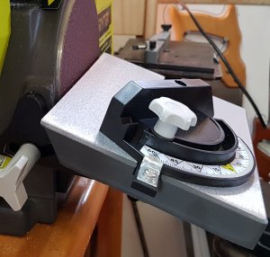

How many times that you need to sand a piece of timber to an exact angle and you find that you have to do multiple attempts until you get sonethung close to what you needed?
Well to me once was too many. I search Ebay for a gadget and found this one.

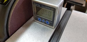

After checking to see if the sanding platform is square to the disc. Place the inclinometer on the platform.
Step 2

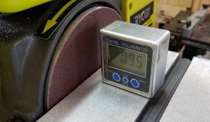

As in my case my bench top is not exactly level (I don't think anyone will have a perfectly level work bench), so I pressed zero to make the inclinometer thinks it is level.

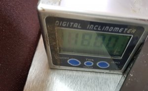

Then adjust the tilt platform to what angle you want. In this example I chose 18°.
Now my sander is ready to sand st the prescribe angle.

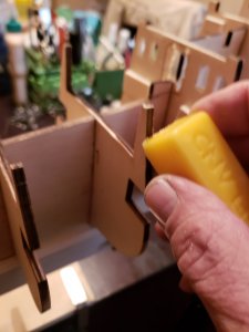

some Ships require you to cut off frame or bulkhead ends after the bulwarks are installed this can be a real pain in the rump if glue gets between the bulwarks and the upright on the frame or bulkhead. I found this trick years ago since I built a good number of Mamoli, Mantua and Sergal ships which always require this step for some reason. I use wax on the uprights to prevent glue sticking there this makes it simple to just cut it off and flush it up with the deck with a sanding block. no more having to pry it from the bulwarks and clean the glue from them 20180903_170712.jpg
