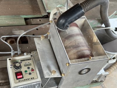

One aspect of a ship scratch build is the sawing, thicknessing and finishing of hull planks and decking planks. I have a good thicknesser and buzzer, but a sanding thicknesser appeared to be necessary in order to have available planks with thicknesses in the 0.5-2mm range.

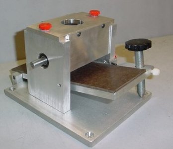

I looked at all of the Google Images of modelers drum sanding thicknessers, as well as those in SOS. With my experience in metal working I decided to make the machine in metal, specifically aluminium. The finished machine is in the photos.
Initially I planned to incorporate powered feed rollers and I showed some plans to my model engineering club. As well as multiple photographs of other peoples machines. One older member suggested that I use a simpler design, so that is what I did.
Most ship modelers drum sanders are in the power range of about 150 watts, but I actually chose a 750 watt AC servo motor (almost 1 HP), thinking that the extra power and size might be useful for furniture making projects as well. The motor and controller was purchased on Ebay Au, for $AUD160, and included a speed and direction controller, soft start, and all connectors, plug, RPM display in a very neat package. (see photo). All other materials in the build came from my workshop supplies, including sheet and bar aluminium, bearings, all thread and fasteners. So the total cost for me was $AUD160, plus 3 or 4 workshop sessions of 4-6 hours each.
I do have plans to change the height settings with a more elegant solution than the pair of M4 thumb scews.
The photos show the finished machine. I will add plans to this post if there are any requests.
photo 1 was the inspiration for my machine. With thanks and compliments to the designer of that machine.
photo 2 is the motor and controller.
photo 3 is my almost finished version. Note the acrylic top
photo 4 is thicknessing a 44mm wide piece of Tasmanian Huon pine. The 1hp motor copes with ease, but the 240grit paper is too fine for thicknessing. At that stage I had not installed the transparent top.

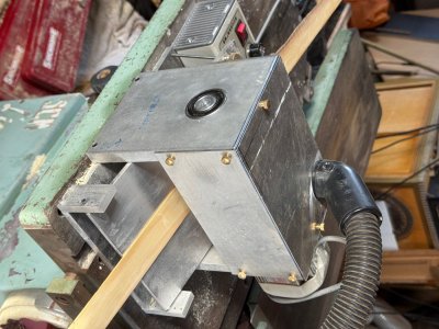

photo 6 shows the countersunk screws which hold the strip sandpaper ends. The method seems to work well.
photo 7 is a closeup of the finished surface. Pretty good!

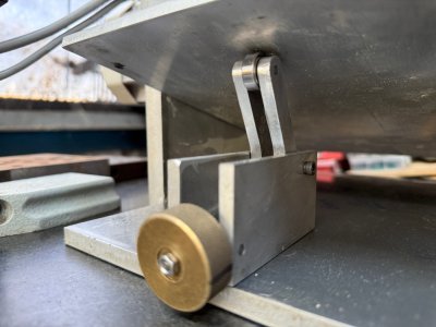

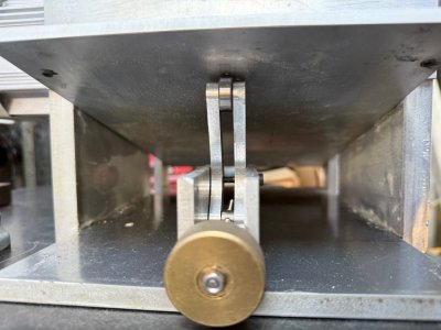

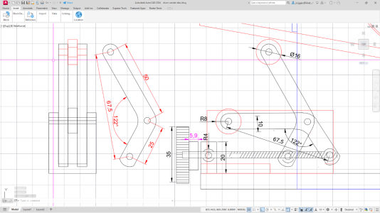

Just a p.s. I felt that the M4 thumbscrews which adjust the platten height looked a bit daggy, so I designed and made a better one.
photo 1 the side elevation dwg.
photo 2,3 the finished and installed mechanism.
Each turn of the big brass adjusts the platten height by 1-2mm.simplified diag.pngIMG_6405.jpgIMG_6405.jpgIMG_6406.jpg
Each turn of the big brass adjusts the platten height by 1-2mm.View attachment 549681View attachment 549682View attachment 549682View attachment 549683
Hi John,
Just one question. Did you notice any flexing in the adjustment plate, or even still slight vibration, as each side does not have support?

Hi Gary, no flexing at all in the 6mm thick alu plate, and no detectable vibration. The almost perfect surface in the thicknessed wood is best point of assessment. The only cost to me was the motor and controller, because everything else was found in my workshop. And the pleasure of making my own tools was the main motive, with cost saving a secondary gain. John
