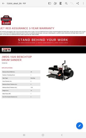

Consider a commercially available thicknees sander if you're serious about produing thin stock. They can go down to 1/32" thickness, which is VERY thin. Not inexpensive though. I use a planer and a spindle sander.
...a bit pricy, though, but a quality brand name behind
