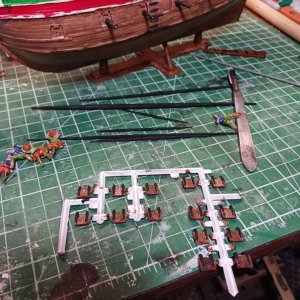

And Sir Francis Drake is inspecting the sails, he not sure of these sails, but will see what I can do with some paint first, Then make a decision about cloth sails or silk span
All the pieces have been painted, another coat of yellow on the sten and it just sails and thread left

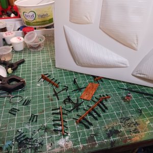

Making of the sails: After the wash coat of Holy white, I glues a 1.3mm bolt rope on all the sails. 20250501_103049.jpg
And of course I had to see what they looked like, a little highlights I think they will be fine.

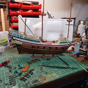

Well this is as far as I got with the Hind, I have 48 clove hitches left on the main mast, all the rest are done. 20250514_182058.jpg
I also ran the fore stays but had to call on fellow member @GabeK to make me some heart blocks and timble blocks ,he is just fantastic with his printer. I tryed but totally failed the holes for the timble blocks was off center and they were cut at an angle, that's why I kit build, cutting a 2x4 in half the pieces don't line up together after the cut lol
