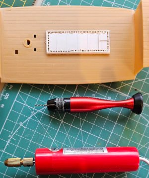

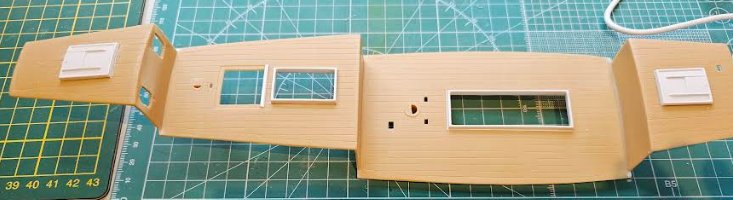

The original kit has four hatches instead of gratings (the open part here is for the whipstaff).
I decided to open the two middle hatches and add gratings there, but keep the front and rear hatches for some variety.
After spending about an hour with my pin vise, I was able to remove the smaller hatch. Then I remembered that I recently bought a tiny USB powered drill and with that I was able to open the large hatch in under a minute. Being an idiot is a real disadvantage.
Then I repainted the hatches.

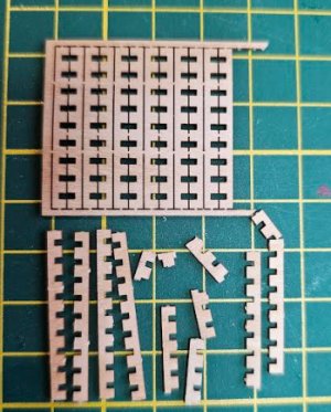

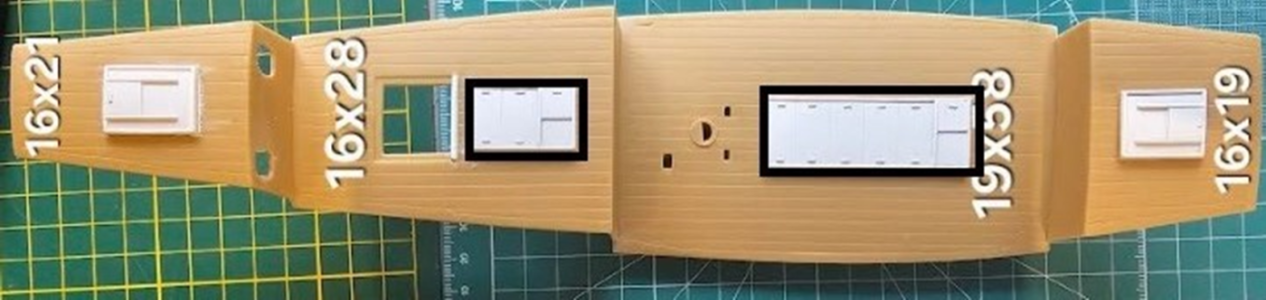

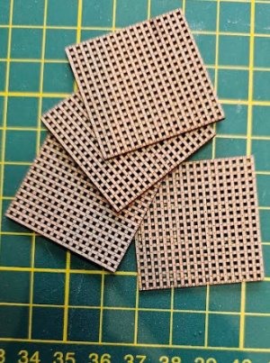

I bought some gratings but had a less than 50% success rate in removing them from the frame without destroying them! Is there a trick?
So I decided to buy some that are already assembled. I will need to trim these to the right size. Hopefully I can do that with a better than 50% success rate!
