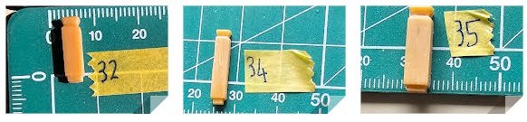

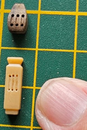

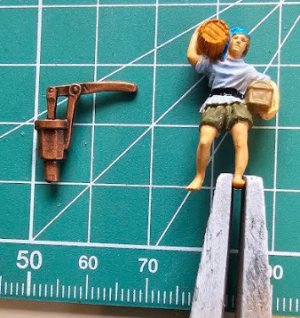

I come seeking advice ... on pumps.
The Airfix Golden Hind does not include bilge pumps. I think they were probably present. So I have bought one that I think is of the right kind.
The scale seems right - the figure is from the kit.
My questions are
1) is this the right sort of bilge pump for the time?
2) I assume there should be a pair?
3) And they should be either side of the main mast...
Thanks for any advice!

I think I have answered my own question :-)

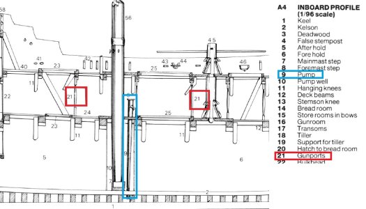

I looked in Lavery's Anatomy of the Ship book on the Susan Constant, 1605, a contemporary of the Golden Hind. The two ships seem very similar. Anyway, the pump looks right, and there are two, and they are near the main mast.

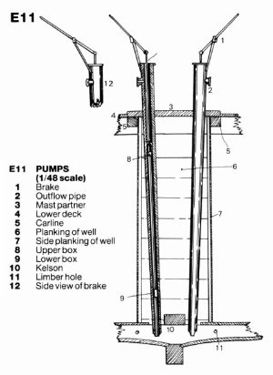

And here is the description from the book.
("The Moon" is a contemporary of the Susan Constant (and hence GH) for which there is more information; Lavery used it as one of his references for conclusions about the Susan Constant.)
Diagram A4 shows the pumps are not on the weather deck, but the gun deck.
If the GH followed the same design then this might be why Airfix did not provide pumps for the kit...
Maybe I should NOT add pumps to the GH weather deck?
Anyone got any knowledge of this?

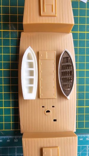

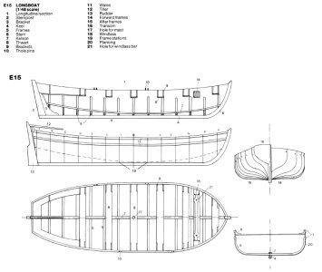

And now for a question about the longboat. But this time I have read the Susan Constant reference first :-)
It is thought that the Susan Constant had a shallop as well as a longboat. Especially because of its lengthy voyage, and I expect that would also apply to the GH. It is likely that a longboat would be towed along behind, but I don't want to do that so I will add it to the weather deck. I bought two boats that I think are suitable. Here are the dimensions from Lavery's Susan Constant book, based on another contemporary ship of similar size:
So the length is 21'3" = 255" = 647.7cm which, on 1/72 scale, is about 9cm. The boats I have are about 7cm, which is close enough for me.
The width is 7'5" = 89" = 226 cm which scales to about 3cm. Mine are about 2.5 which again is clsoe enough for me.
The example given in the Lavery book is below, which is more like the shape of the boat on the left.Pic-1165.jpg
But I like the one on the right more so I think I will use that one :-)
JL
