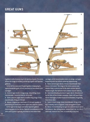

My extra cannons for the gun decks arrived today! They are brass. I guess I should paint them matt black? Is it true that sometimes they were left in the raw metal? I thought I read that somewhere. What is most appropriate for 1580s? I notice that Kirill's (spectacular!) galleon has black cannons.
Good day John,
On my model on open deck ,guns - they are iron wrought breechloading bombardas, that why I painted them wrought iron color, on english galleons of that period bronze muzzle loading type guns were widely used, and You could left them bronze color with patina but not matt black.

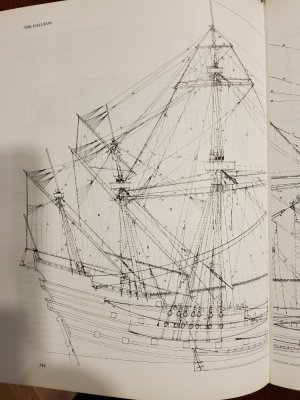

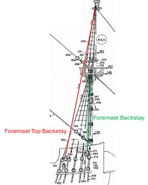

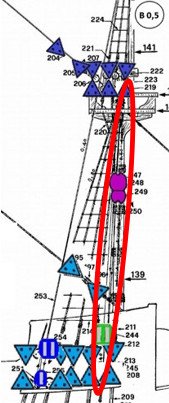

I have some questions about the standing rigging on the GH. I am looking at this so I can ensure I have enough belaying points on the deck. Sp the first question concerns the line circled in red. This is the foremast but there is an identical one on the main mast. It has a violin block (purple) and a double block (green). But what is the line called? It is a tackle I guess. I woudl have thought it was a backstay but there is a separate backstay (with the blue blocks, a little to the left this line).
What is this line called?

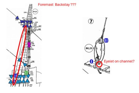

A related question, concerning what I think is the "foremast back stay" - the one going through the two blue blocks in the figure above, and also highlighted in red in the figure below (same figure basically).
According to the supplementary diagram the single block ends in a hook which no doubt connects to an eyelet on the channel. But the other end of the line...does it go to an eyelet on the channel also?
Thanks!
Well I sorted the naming of the lines. The original diagram (without my annotations!) clearly shows the rear stay going all the way to the top yard so it is the foremast top backstay; the forward one is the foremast backstay, I believe.

As I remember for this period, running back stays were in use, they have a little bit different arrangement , yours 67 question - I quess it is mast tackles ...running end of the rope could be secured on itself or on the rail nearby lower block...
For best and 100% understanding what ,how and where all rigging lines must be arranged - You need to read and permanently keep under hand as valueable source of information - this is RC Anderson book "The Rigging of Ships in the days of ..." this book will cover 100% questions of galleon rigging...when read You be need to choose information conserning english style of rigging...

As seems to me it would be much better to use those plans ( Kirsch, Beker, E.Troppman and RC Anderson book )to rigg your GH model than that plans with rough mistakes which You use now /I mean that fragments of rigging plans which You posted above , beside wrong back stays arrangements ,they have round deadeyes which is nonsense for galleon rigging... what else mistakes they have?

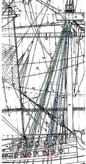

Ah yes..and thanks to you I have a copy of this. I just loked it up and it shows the eyelets on the channel, for attaching the blocks. BUt they both seem to go to the main yard (well the top) and not to the top yard. So it looks like two back stays for the foremast which go to the main yard and none that go higher?

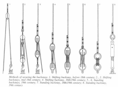

Mondfeld also says that running stays (he calls them shifting stays) were in use then and shows how they changed over the years. The one onthe far left matches what I have in my rigging diagram (from HiSmodel)

Me personal, on my model, Ive used No1 for back stay for the 16tn ... Don't hurry up... I would reccomend ...jist slowly going down trough Anderson book, each article relevant to your actual stage of your model rigging, to understand what he is talking about , and just follow what he says
You will be surprised how simple are the rigging are, that You could see on the models and pictures ...:)))
That riging lines #33 You marked blue and green on Peter Kirsch galleon model - they are botn should be mast tackles, mast tackles..but He says they are breath backstays which is strange for me....
As I could see, He didn't show back stays in his reconstruction of his galleon riggings... the initial source of all rigging reconstruction - see Anderson book
His Model used no3 variant by Mondfeld ...and question why... for the galleon ...?
but not No1 as it should be ,as shifting back stay...according to the Anderson/Mondfeld ... again, better to follow what RC Anderson says than any others ...
Mondfeld is Great! He gives universal answers, but You need to choose right one between many... :)))
