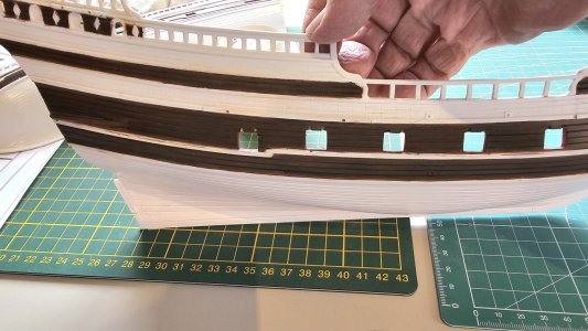

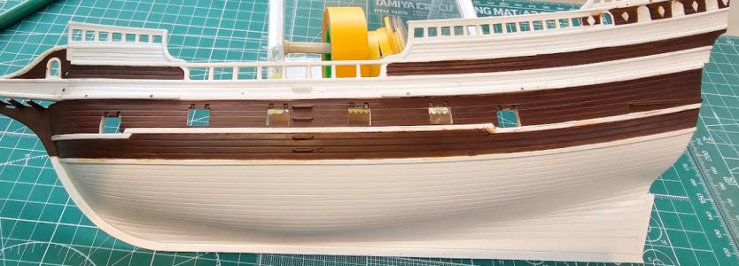

I have spent the last few days masking (and masking and masking...) the GH hull so I can put the dark brown base coat under the places to be brown painted wood. That is now done. And I have used oil paints to add some texture. I will post some pics soon. I will let that cure for a week, and then I start the hand painting of the wales and the decorations. Scary stuff :)

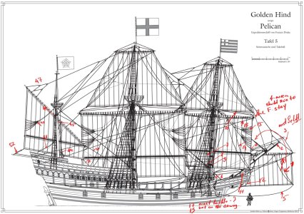

That riging lines #33 You marked blue and green on Peter Kirsch galleon model - they are botn should be mast tackles, mast tackles..but He says they are breath backstays which is strange for me....
As I could see, He didn't show back stays in his reconstruction of his galleon riggings... the initial source of all rigging reconstruction - see Anderson book
Hmmm. My copy of Kirsch has many pages missing. I realised this because I do not have the page you posted, which identifies the numbers of the lines in the figure.

Dark brown parts of hull painted. I wanted it to appear as wood that has been painted...er...dark brown :-) I usually use some oils over that to get texture and grain but they don't show up very well against a dark base. I might try the lifecolor acrylics as a wash, once the oil has cured. So for the next few days I will be working on a B52 for a friend. Talk about extremes of technology!

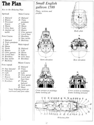

I have ordered the GH plans from Eugene. The belaying diagram is in German, and I have tried to translate as best as I can. The file below was constructed with the help of some German friends, If anyone can help extend entries, or clarify terms, that would be very welcome! Cheers.
Hello John,
You can use any of specialized maritime dictionary for this, beside that, as I remember, in Markvardt 's book "Rigging of 18th ..." there is tripple dictionary french- german- english in the end of the book. That famous Mondfeld book about ship modeling, on the first pages has couple of very nice diagrams with rigging and belaying schemes of GH rigging...and in my opinion he made more accurate version of sprit sail rigging than Eugen/ that part which conserns spritsail braces only...You could see by yourself when You reach this stage... but this is only my private suggestion...
Any progress with translation?
I guess You already have Mondfeld's book... as I mention above, there are couple of GH rigging and belaying points diagramms... similar to that what Eugene made, all points in english... actually GH has very standart and not complicated , classic square rigging scheme, there should not be any black spots... I hope You have RC Anderson book where He gives detailed explanation of each rope, and there is another value source of small 16th galleon rigging - "The Mayflower and other colonial vessels" by W. A.Baker - there are detailed rigging plan of MF which is identical to GH rigging, and a few lists of all rigging lines with relevant rope sizes and description of each rope - I would very recommend this book....

My suggestion ... on my drawing I don't have mast tackles...17 and 36 are tackles of F and M Top masts backstays, they are mirrored...on both sides
There I have some doubts, in this period they should be running backstays, rbs have different rigging arrangements...
I doubtful there are correctly rigged braces of spritsail, I think running end of spritsail braces should start from the fore stay, than trough pendant brace block than back to the lead block on the fore stay and than to the forecastle... ?
When spritsail braces run straight to the forcastle than spritsail couldn't be operated... it should stay more-less, perpendicular to the bowsprit and turn around it , not like main sails move around masts....

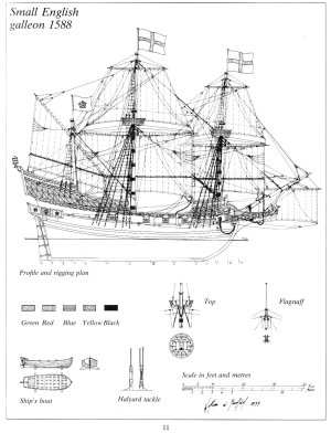

there are a couple of Mondfeld reconstruction plans - all the same as on the Eugene's drawing and his belaying scheme - check

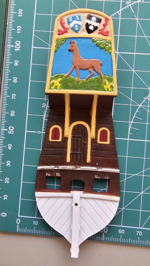

After waiting two weeks for the oil paints to dry (on the GH outer hull) I will resume the hull painting in the next few days.
I used some lifecolor acrylic pigments to add some texture and colour shifts to the dark brown.
I have ordered some paint pens which I thought might make it easier to paint the enormous number of triangles...
