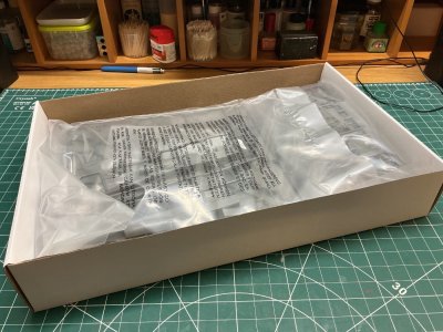

Let’s get that big red box open.
Phew, what a pong! It’s a funny thing about Airfix kits these days - they smell bad when you first open the box. Think of baby sick - a sour milky smell. It fades quickly, or perhaps I just get used to it. Presumably it’s something off-gassing from the plastic and being retained by the plastic bags. I actually did my opening survey last night, say 18 hours ago and it’s still faintly detectable but only if i sniff for it.

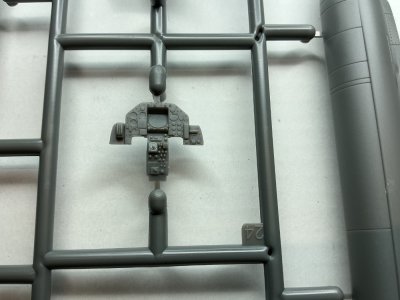

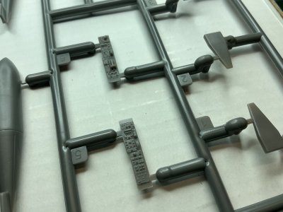

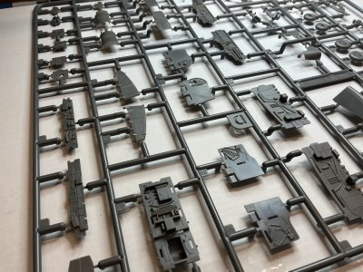

There’s my always favourite component - the inst panel. I used to be an electrical and instrument fitter in the RAF and spent a lot of time with these things. They are also the most fun to paint and really the main point of interest for the viewer of a model. It’s the keystone of the cockpit and that’s where the human interest is - where the meat meets the metal. This one’s quite good enough for me.
That’s the real thing. I think the Airfix version is close enough for 1:48 scale. My reference book quotes a pilot as saying they the cockpit of this aeroplane was an “ergonomic slum”, important when you are flying fast and low and don’t really want to have to look down to find a switch somewhere close to your ankles. They improved things a lot in the GR1B version.
Airfix have moulded the side panels separately from the cockpit tub which will make painting them easier. Not easy, but easier.

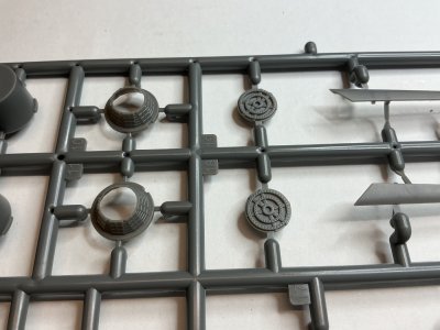

The tailpipes are another area of interest to the aircraft modeller. These are a little thick, a little simple but I must bear in mind that it’s a relatively cheap, almost mass market kit and that resin replacements will be available from half a dozen aftermarket specialists. Personally, I’ll see what I can do with the kit supplied items.

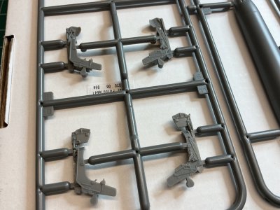

Two ejection seats are included. The GR1 and GR1A had different marks of Martin Baker seats. This is one thing for which I might buy a resin or 3D printed replacement. It’s another focus of interest and the harnesses etc are really complicated to make from scratch.

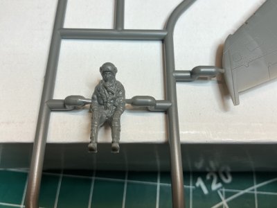

There’s Rodney. I think the moulding is too soft, rounded edges everywhere. It would be very challenging for me to paint that. So I won’t. Personally, I think models look silly with pilots inside, especially with their hands on their thighs like that are posing for a photo of their equipment for a Safety Equipment poster. I would not be surprised to find that such a poster was the source for the design.

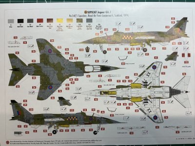

Nice decals. Plenty of stencils and four main schemes - all RAF. Two in grey/green wraparound, one in Gulf War One desert paint and one in grey/green/white which is my fave as its my period and I’ve been to Lossiemouth where it was based in 1974.
This one. Although I am tempted to over paint the green with white for the famous Norway camouflage, applied temporarily once a year for deployments to Bardufoss.
The effect is a little muted in black and white but I always thought it made a pleasant change from green and grey. Also, being soft edged, I wouldn’t have to bother with much masking.

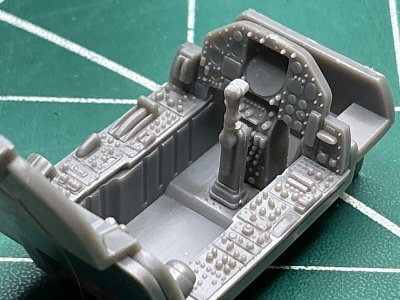

There’s the cockpit tub, mostly dry fitted together to familiarise myself with where the various bits go, and in which order, and for this photograph of course. It looks horribly blobby when enlarged to a zillion times life-size, but let’s not judge it until it’s painted, and ideally not until it’s sunk into the fuselage and barely visible. You may notice that there is something missing from that photograph?

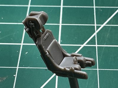

Here it is! It’s a Martin Baker type 9B Mark 2 ejection seat. It is moulded well enough to be clearly distinguishable from the Martin Baker type 9B mark three ejection seat as used in the GR1. Incidentally, for those not familiar with Royal Air Force aircraft nomenclature, the G means ground attack and the R means reconnaissance which were the main roles of the Jaguar.
Once again, the moulding is somewhat blobby and very thick in places too. The whole kit is going to be like that under magnification so I’m not going to mention it anymore. Ya pay your money, ya takes your chance! I wanted to show the seat in place in the cockpit tub but unfortunately by the time I thought of that I had alreadyglued a piece of sprue to its base to give me something to hold onto while I paint the little darling. I also have to improvise some kind of harness since that is not provided. The assumption being that I would stick Mr. Blobby the pilot onto the seat. So it’s my fault really.

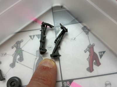

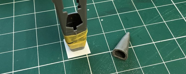

Well, I found and tidied up all of the small details without a problem. Unfortunately I then bumped into something interesting…

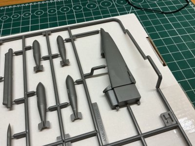

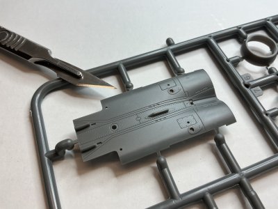

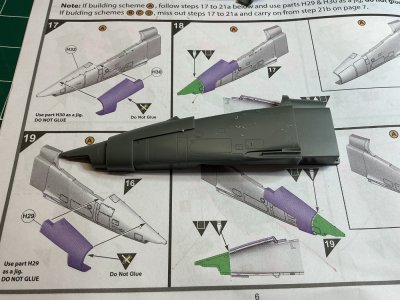

In order to build my 1974, 54 squadron option I have to cut the laser nose off and replace it with the earlier conical nose. Usually when this is required a kit manufacturer will mould a cut line on the inside of the fuselage. The model then uses a saw to hack off most of the waste and comes back accurately to the line with files and sandpaper. In this case a jig is provided to guide the cut. Foolishly I attached the jig, brought my saw next to it and hacked away. What I should have done was use a scalpel to mark the edge of the waist (waste - I dictate these updates to save time but returning to edit out all of the homonyms is tedious so you will have to put up with them in future, I’m sorry.) and then come up to it slowly with files and sandpaper. The jig is of course as soft as the rest of the plastic and my enthusiastic sawing, together with my inefficient eyeballs caused the cock up that you see in the next picture
Silly me. Neither of those cuts are perpendicular and the port side is a millimetre or two too far aft at the centre line. What a marvellous start to the build.:confused:
I will assemble the conical nose, which comes in two pieces, and leave it overnight to set . In the morning, I will temporarily fasten the fuselage halves together with masking tape. Only then will I know whether I have cut too much or too little. Stay tuned for the next exciting episode of ‘Smithy Gets a Little Saw’.
It should be an easy fix if you have some spare ABS material from Evegreen.
Indeed. Polystyrene rather than ABS but that’s the way to bodge it.

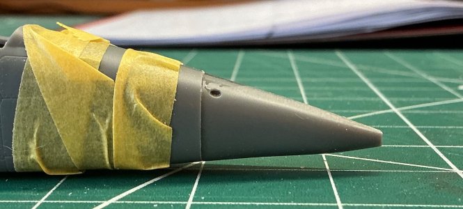

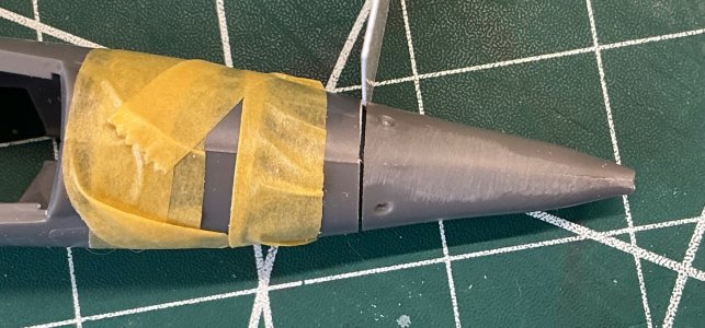

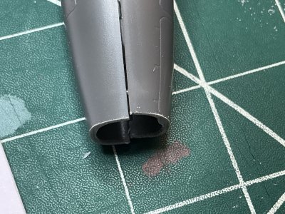

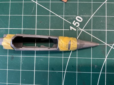

It was necessary to file the hacked off end of the fuselage to bring it perpendicular to the centre line and also perpendicular to the ground. Any length that was lost would be made up with polystyrene shim.

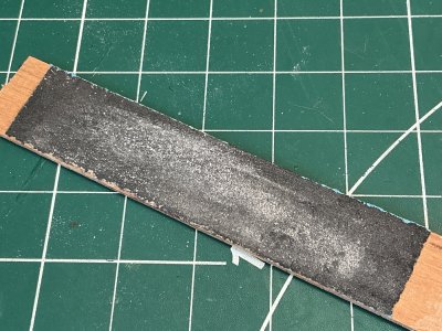

Steel files are of limited utility on soft plastic as they clog so easily. I use wood glue to stick wet and dry abrasive paper to flat pieces of wood, making cheap files in any grade which are more resistant to clogging. This is useful on wooden boat kits as well.
Squaring up the end of the fuselage caused me to lose a certain amount of length, perhaps a millimetre, as you can see from the step up between nose and fuselage.
I had no accurate way to measure how much plastic I had lost so I tried a succession of thicknesses of plasticard until I found one that more or less eliminated the step up.
I cut an oversized shim and glued it to the fuselage. I then had to remove the flange from the nose piece. That was easier and safer than cutting out a hole in the middle of the shim. When the shim is fully set in position will trim it to size and then align the nose piece by eye. Anything that I do by eye causes some drama, but in this case, I think I will be able to manage it.
Dammitt! I am so stupid these days. I glued that shim to the two sides of the nose fuselage before I had built the cockpit and nose wheel bay and assembled the whole thing. One frustration after another! I don’t mind making mistakes and fixing them. I object to making mistakes and then making mistakes in the fix. Fortunately I realised what a dumb donkey I am before it was too late to rip the shim off.
