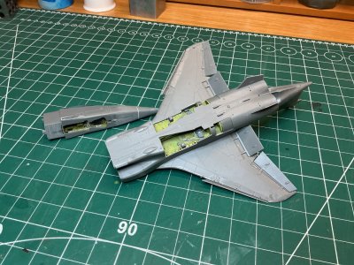

The assembly continues. With the flaps and the strakes added, the complicated, but I think graceful shape of the Jaguar is beginning to develop. I haven’t put the nose on yet because I have yet to mask off the canopy and I thought it would be easier to do that if I put my nose in a vice.
For a while, I thought that it would be more ‘efficient’ to have two units to work on. I could glue something to the nose and then while the glue was drying, I could glue something to the remainder of the aeroplane. I would use critical path analysis. And then I corrected myself. That kind of thing is efficient in our working lives when we are required to produce something in the minimum amount of time. Now that I am retired, a possible definition of an efficient hobby is one that fills the maximum amount of time at minimum cost. It serves me to build my models as slowly as possible.

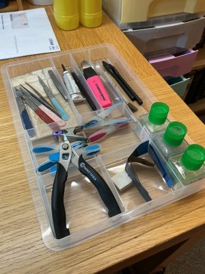

My modelling bench is also my dining table and this has helped me to get into the habit of using this partitioned plastic tray for my regular use tools. I am not completely disciplined yet, but most of the time I pick a knife or a pen or whatever from the tray, use it and then replace it in the tray. This is the kind of efficiency that I like to employee. I hate wasting time looking for things on the desk. That’s no fun at all.

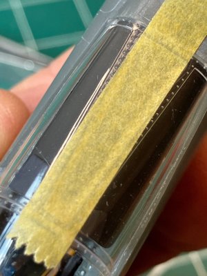

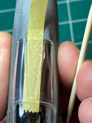

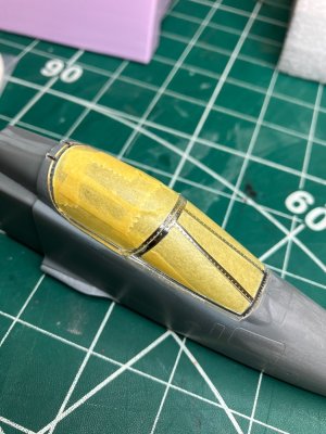

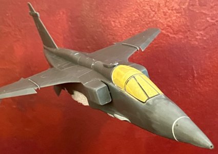

If putting the decals on the aircraft is one of the highlights for me, then masking canopies is the nadir. I have been finding little excuses not to do it; too tired, too busy… But even a master procrastinator such as myself can’t put it off forever.
First, sharpen your saw - or in this case fit a brand-new blade.
And the old blade is safely put away.
I always use Tamiya masking tape. It’s more expensive than some of the alternatives, but it is the best, in my opinion?. (Other opinions are available. Terms and conditions apply.)

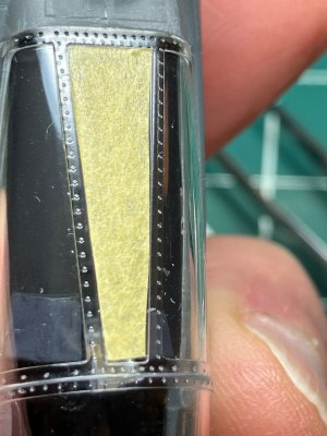

Once the tape is in position, I push it into the angle between frame and windscreen with a toothpick. Preferably a wooden one. This bamboo rubbish is splintery and hard enough to scratch the plastic. It was misleadingly advertised as wood, but at least I got my money back.
Then comes the drama. Running a knife around the edge of the frame. If your blade wanders you will make an irreparable mess of the glass!
The compound curves of the movable canopy aren’t as tricky as you might think. I simply work around the edges and then fill in with scraps.

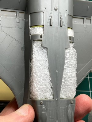

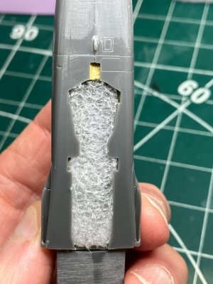

Using masking tape on a deeply concave area such as an undercarriage bay is very difficult for me. Packaging foam is much easier and more secure.
And ditto for the mains.
With the masking done, I have given the Jaguar a nose job

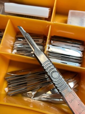

Nice to see the care that you take for the preparation. And often change the scalpel knife is a good option. The price of a box of 100 isn't a bad deal. Especially if they don't need to be sterile.
Years ago I bought 500 of each of the five types I use. That drove the price per unit very low and I have a lifetime supply. For a while, I thought I had more blades than I would ever need.

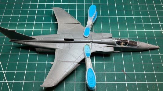

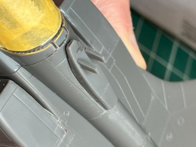

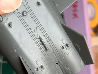

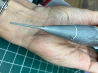

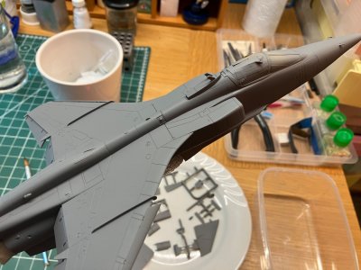

The spruces are empty now that all the fiddly bits are attached. I’m delighted to say that I didn’t drop anything onto the carpet, which has got to be the first time that has happened.
There are now aerials and vents and scoops and sensors, all of them very delicate, attached all over the beastie. This makes handling the model a very difficult for me with my clumsy fingers. Next job is to find a way to hold it safely for painting and then finally we can get some colour on it..

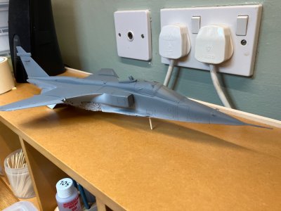

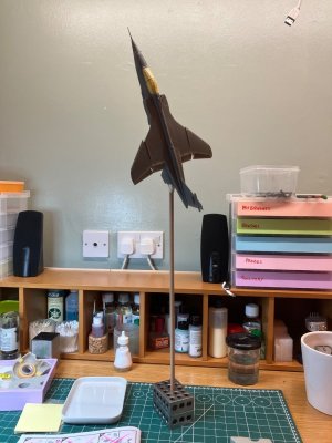

It’s now primed, two coats. This is one of those transformative operations when the model, previously a loose collection of parts and glue marks becomes a single integrated thing. Despite my many errors in construction I’m happy with the result.
The primer is Stynylrez from the Badger airbrush company and as you see, it’s self levelling, heavily pigmented and sticks like stuff to a blanket. In fact, my only criticism of the stuff is that it’s the very devil to get out of my airbrush at cleanup time.
I had planned to paint the undersides this evening but I’ve had a nip with dinner and no longer trust myself not to stage a disaster Bottle
Deferring the painting gives me a day to walk about with the paint in my trouser pocket where the warmth and agitation will thoroughly mix and revive the paint, unused for years. I did the same with my bottle of primer and had zero blockages while spraying.

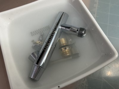

It seems that I was right. I tried spraying the very pale gloss grey on the underneath today. The airbrush just would not cooperate. I got two coats down but very badly. I stripped the brush for normal daily cleaning and it didn’t seem to fix it. Then I asked myself how long is it since I did a full annual overhaul? Er… 2019?
It will sit in that bath of alcohol for the rest of the day to soften up the many layers of paint crud which inevitably get past the needle seals, a few molecules at a time, jamming up the trigger and air valve.
Airbrushing isn’t the easiest skill to acquire and there are two mistakes which newcomers to spraying always make. The first is not thinning the paint enough and the second is neglecting routine maintenance of a precision machine. Guilty as charged your honour!
