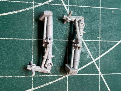

Definitely tedious landing gear assemblies.

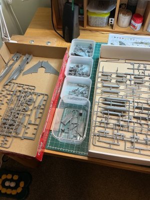

I’ve been cracking on tonight. All of the interior components have been cleaned up ready for painting and a lot of the external airframe sub assemblies are now ready. I’ve decided not to fit any weapons or even the underwing and belly pylons. It’s the aircraft itself that I’m interested in and hanging lots of weapons underneath a model is just asking for trouble, if not during the build then during the subsequent dusting…

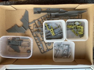

I was busy yesterday, but this morning I sprayed the base colours on the cockpit and undercarriage components. I haven’t done any airbrushing for a very long time, and fortunately those skills seem to be holding up. I guess airbrushing is more of a mental than physical discipline.
The box full of parts is shrinking agreeably.

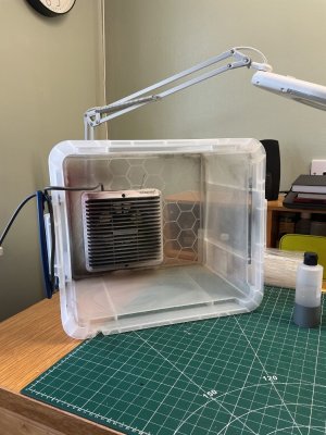

Finally, here’s a look at my spray bay. It’s very simple just a fan in a box. I use a flexible plastic ducting to take the smells and dust out of the window. When it is not in use the detachable ducting, the power cable, my mask, rubber gloves all fit inside it with the lid on to keep things tidy.

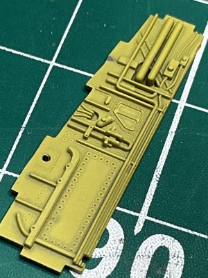

I’ve run some dark green enamel paint, thinned to a wash around the undercarriage and cockpit pieces. The idea is to simulate shadows and dirt, and modulate the base colour to make it a little more visually interesting.
There’s another great advantage of this simple technique. Because all of the internal corners are now painted very dark, when I come to brush paint the electrical wiring and various black boxes and pipe etc, I won’t have to paint all the way to the bulkheads. This is one of the ways that I hope to compensate for my cheeky old hands, which would be inclined to make a bit of a mess otherwise.
On the left is the off-white base, on the right after the wash. Unfortunately, this technique does bring out all of the little errors such as the seam lines which I have not cleaned up. Everything is a compromise.

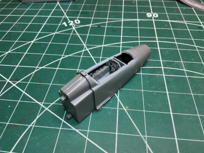

In between reading, watching movies and dragging the dog out into the rain occasionally I managed to do some work on the nose section.

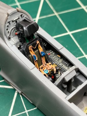

I’m afraid my cockpit turned out to be more impressionistic than realistic. But I think it’ll look busy enough once the seat’s in.
Not too happy with the nose wheel bay either. I suppose it was good practice. In fact, on the Jaguar, the large gear doors are only open when the undercarriage is in motion. Once the wheels are locked down the doors re-close. This was to stop mud and sand being thrown into the bays when the Jags were operating from unprepared surfaces. The doors could be opened on the ground for maintenance purposes. As usual, the designers put all kinds of electrical and hydraulic units in there for easy access. So I have options, I’ll paint the bays and if I like them, I’ll use open doors. We shall see.

First, I’d say you did a great job. The cockpit has enough contrast to look the part. With the canopy on, it will probably look very convincing. Also the gear bay is looking good as well thanks to all the detail on the piping, etc. If you dry brush a few highlights I think you will want it to be visible. But we both know you never see that unless you pick up the airplane and turn it over. ;)

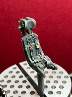

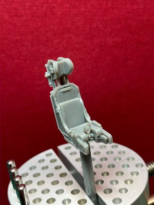

Not today though, because today I have been ‘improving’ the attraction seat. (That is a typo but I rather like it because the seat does attract the eye of the beholder).

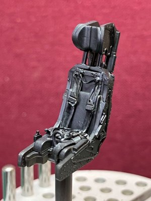

Here is the seat as supplied by Airfix. A good candidate for a resin replacement, but I am too tight to spend any more money before Christmas.

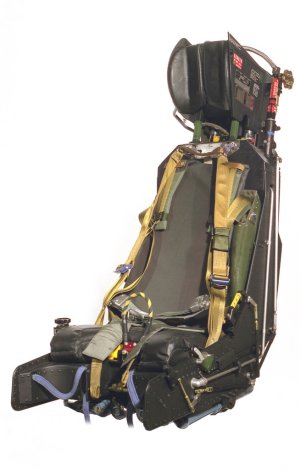

Here is the seat as supplied by Martin Baker. Like the photograph of the cockpit it is far too complicated for me to slavishly copy. But I am making a model and one useful definition of a model is a simplification of the real thing. So I looked at this photograph for long enough to get a general impression and then did this…
I used thin strips of lead foil secured to the seat with superglue where they touched. Then I added the buckles from random leftovers of photo etch. This is going to be one of those sub assemblies that is damn hard to paint but if I had painted the seat first, the superglue would not have worked for me. I know this because I have tried it before. On the other hand, I have bought resin seats with the harnesses moulded on and somehow managed to paint them to my satisfaction so this might still be within my capabilities. I don’t trust superglue so I’m going to leave it overnight to set really hard before I even blow on it with my airbrush.

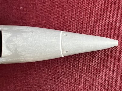

When I came to clean the brush, I neglected to remove the needle and nozzle. I unscrewed the paint cup but completely forgot the rest of the disassembly, despite having done it thousands of times before. Consequently, a 28 psi jet of air was directed into my bowl of dirty black Isopropyl alcohol - with hilarious results. I wear glasses so my eyes escaped undamaged but that stuff tastes foul!
Tell me fellow mature modellers, do you suspect as I do, that we are all becoming less intelligent as we age? Redface I seem to be specialising in stupid mistakes. Another example, once the front of the fuselage was assembled, I glued that shim to the front of it and then glued the nose cone to the shim. I let it dry solidly and then sanded down the shim only to find that I had incorporated a step into the smooth contours of the nose. I couldn’t understand this. Eventually I realised that when I had removed the shim earlier in the week after I stuck it on in error, I had roughened up the surface. I had sanded that flat but did not allow for the extra material that I had removed. I used the same thickness of shim as before. I should’ve gone up a size.

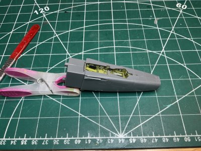

I have done my best to sand away the step, losing much of the delicate surface detail of the nose and building in some supermodel curves in the process. It will have to do because I am no longer capable of rescribing. I tell myself that panel lines are invisible more than 20 feet away from an aircraft so it doesn’t matter. I’m not sure I believe myself.
The story of the nose is now that I cut it badly, repaired it and mistakenly glued it up, tore it apart and later mistakenly reassembled it with the wrong shim, then mistakenly sanded it into strange curves. FOUR silly errors of judgement. Thank heavens I no longer work on real aeroplanes. ROTFROTFROTF

The seat looks fantastic, you did a great job. The seatbelts look very convincing.

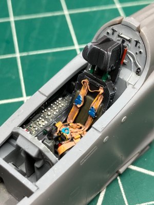

I am quite pleased with the weekend work. I am learning to ignore the cock ups and appreciate what did go well.

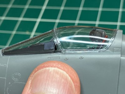

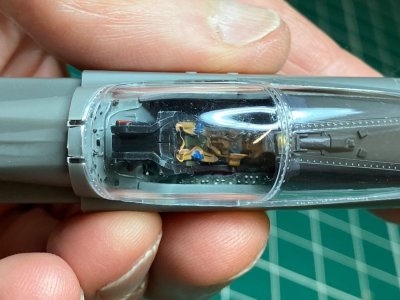

Just look at that windscreen. It makes the aeroplane look like it’s doing 1000 miles an hour before you even take it out of the hangar.

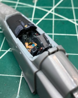

That’s what the cockpit looks like with the canopy closed. It does seem a pity to lose all of that detail so I have decided I will open the canopy. I have stuck it down with wood glue and sincerely hope that I can pop it off with the touch of a scalpel once I have finished the painting. This is a quick and easy way to mask off the carpet while I paint the exterior of the aircraft.

Love the rivet detail on the canopy frame! An excellent candidate for a wash to make those pop.
