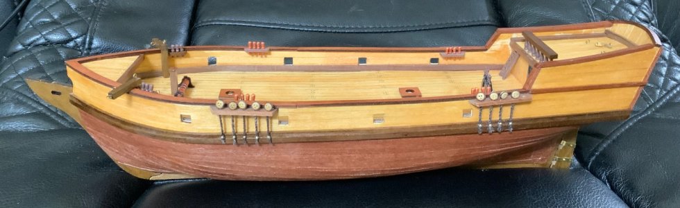

Hi, fellas. Thanks for having me. I’ve always wanted to build wood 18th century war ships. I just retired so now I have the time to invest in a hobby. For my first ship I chose OcCre’s Albatros. I chose this model as it seemed like a good kit to learn the skills I’m going to need. My goal is to eventually build a museum quality ship of the line. We’ll have to see how steep the learning curve is before I can build something as complicated as that.
I’ve just started the planking. The first plank was inadvertently placed too low. When I plank the starboard side I’ll make a better effort to place the first plank in the middle. The instructions showed planking from the middle up, but I was concerned about the top planks being at an angle, so after that first plank was placed I started planking from the top down. On the second planking I’ll place a plank on the port side then one at the same location of the starboard side. I wanted to plank the port side first then the starboard side on the first planking to use it as a learning tool. As you can see the planks look a little ‘wavy’ toward the bow (prow?). On my next model I’ll pay more attention to the bulkheads.
Any advice or criticism is welcome.
I haven't had a full read of the comments but I see a lot of general planking advice. First, be aware that instructions are not necesarily the best thing to follow. On the next build you'll be able to dispense with the basics. And nor are they reliable or appropriate. ie., that plank in the centre is completely unnecessary and will only get in your way. Did they even tell you ways of bending a plank??
Another thing that you'll find is one small mistake in the early stages will bite you very hard later!! Precision is paramount.
(Artesania are not a high quality producer, like most at these price points they're good enough to cut your teeth on. I'm not impressed with the page of instructions photographed!!)
To give a practical opinion, I would remove the planks laid (hot water), fair the hull properly, Soak your planks a couple at a time, and either bend the planks or fix them while they are damp and flexible. They can be set to a proper bend by clamping them to the hull to set. Because you are not going to cover the angled lay of your planks.
This kit shows a simplified method of planking, to do this correctly involves tapering and bending each plank (as in Chuck's video above) But that's for later! Hopefully your nex build!

nice to have you here. If I may be so bold, I would like to say that planking from the center only brings disadvantages. It can happen that the planks run together and you then have to shorten them or even patch them in small pieces. The result then looks really bad. However, if you want to do the planking twice, the first planking should be constructed in such a way that you have an optimum contact surface for the second planking. This has the advantage that you can mark out the planking courses, making the second planking worth seeing and, of course, easier to install. I would never lay the second planking in your planking section in the operating instructions. You would be annoyed for the working time you spent on this.

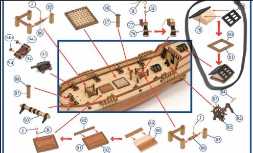

78 is something like a skylight, dont know the correct english term, it let light into the boat and I would add a bit of transparent plastic.
The small ribs protect the windowglass.
PD Lieutenant, welcome to the forum and like me you posted your pics of your build so far, I showed a few more close up pics of my first planking which led to lots of helpful advice including videos. Hopefully you have read them all and watched the recommended videos as I did.
As you have been advised don’t be in a hurry, take your time.
I followed religiously OcCre,s build plans, but would change things now I have a bit more experience.
As others have said you need to get the first planking right as your errors will show up on the second planking.
Based on advice I removed part of my first planking as it was wrong, had to buy more planks. I then replanked the errors and continued and the end result was pleasing.
Good luck and keep us posted

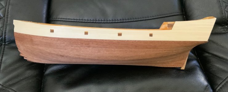

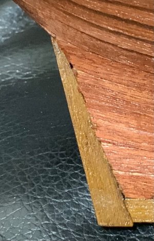

I have the second planking done. I started planking at the top of the bulwarks and worked down to the keel. As you can see not all of them lay flush against the hull. I suspect this is because I sanded horizontally and didn’t spend any time sanding vertically. This is a good lesson for my next build. The planks were very dry and brittle and soaking them didn’t help. Maybe it was just a batch of planks (sapelli) that are old. Now onto installing the keel and finishing the hull with sapelli dye and varnish.
Did you glue wet planks to the model? If so that may have caused cupping as the planks dried on their outsides first, lifting the edges away from the hull.
I didn’t glue the planks onto the hull while they were wet. I soaked some of them just to see if they’d become less brittle and prone to breaking - which they didn’t. The planking tended to chip and break while trying to cut it - and I was using a fresh x-acto blade. I think I got a batch of old dried out planking. At least, I hope that’s the issue with this model. Beyond the brittle planks, I think the problem was my failure to sand it vertically - that’s the only thing I can think of, but this is my first wooden ship model, so I welcome any thoughts as to the issue with this.

Attached is a picture of the chipping I was talking about.
Watch Olha's video a few more times and you'll see that you don't need edge bending. You can also see why she fills in between the frames to be able to attach the second layer. Occre's wood for the second layer is probably always the same, so if you don't use Olha's technology, you have to replace it with another type of wood that allows edge bending or that you cut the plank out of wider strips.
It is absolutely possible to get a nice hull with Occre wood but it requires the right technique and so practice.
Your first hull looks much better than my first, you are on the right track.

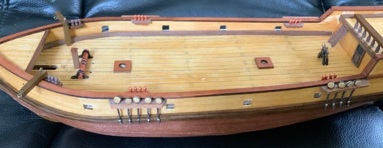

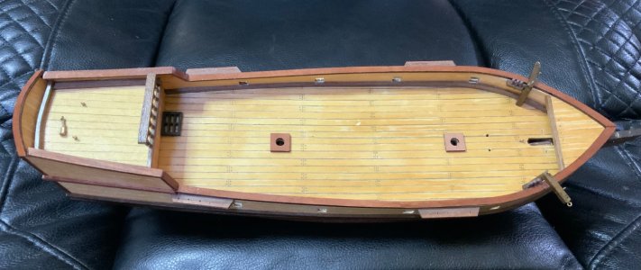

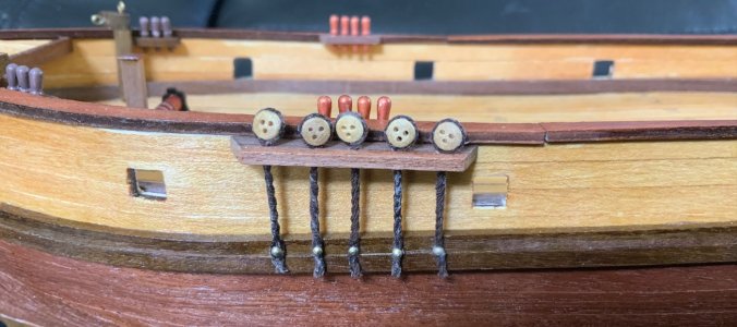

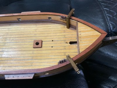

My build of the Albatros continues. The rubbing strakes, limber boards, some pin racks, chain plates channel, cat davits, and railing have been completed. I need to get a drill attachment for my Dremel tool. Hand drilling with my pin vice is long and tedious.
Another hard lesson learned: when I was dry fitting the mast plates I also dry fit both of the masts and found they didn’t fit into the intended slots because of an alignment issue with the deck. I read a few steps ahead, but obviously not far enough. On my next build I’ll be sure to dry fit the masts before I glue down the deck.
