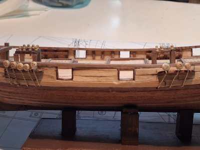

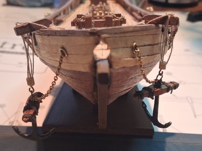

Finishing manual Page 30 of instructions: Davit’s Installation. The Davits comparison photo.
This photo comments on the installed Davits:

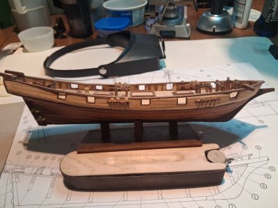

Using the 1.5 x 5 mm boards, shape two each of part 40 and part 41, with part 40 being the foremast channels at a length of 30 mm and part 41 the mainmast channels at a length of 26 mm. Notch the five notches on #40 and the three notches on #41 and attach to the outboard bulwark positioned to match the plan.
Photo of the installed channels both fore and main mast.
The port side installed channels, I just used white wood glue and masking tape to set the parts onto the hull. [Photo_10]

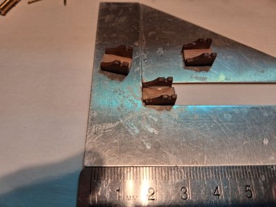

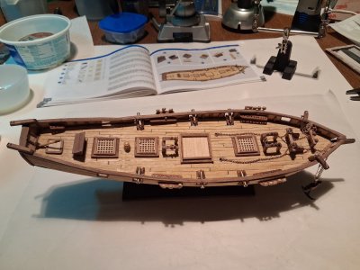

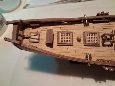

Using 1.5 x 4 mm stock make up parts 54, 55, 56, 57, and 58; cut seven Part #54 from 1.5 x 4 x 28 mm. strip, two Parts #55 and two Parts #56 are 1.5 x 4 x 29 mm. and 1.5 x 4 x 33 mm. Sepelli wood strips, and two Parts #57 and two Parts # 58 are from 2 x 2 x 33 mm. 2 x 2 x 37 mm. Manzonian wood strips. Follow the instructions and illustrations to complete the Cap Scuttles part.

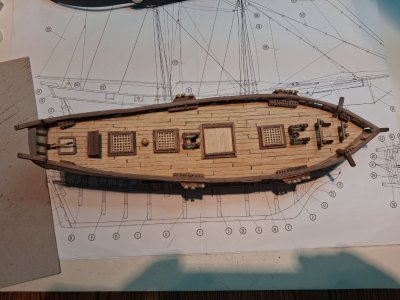

The cap scuttles and helmsman base before the frames are installed.
Framing the cap scuttle.
Cap Scuttle drying.

Very similar to Page 40 of instructions above; Cut Parts 59, 60, 61, and find 62; but this time only three Parts #59 using 1.5 x 4 x14 mm. Sepelli wood strips, then two Parts #60 and two Parts #61 from 2 x 2 x 2 x 13 mm. and 2 x 2 x 19 mm. to form a frame around the base from Manzonian
wood strips. The Helmsman base awaiting framing.

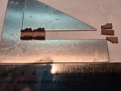

The Helmsman base frames are just 2 x 2 x 14 and 16 mm. This is An extreme closeup showing that the caliper is set to 14 mm. [Photo_08]
An extra photo of the digital caliper reading of the cap scuttle parts before gluing them to each other. [Photo_09]
Cap Scuttle drying.

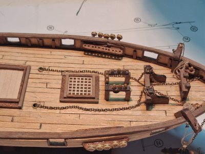

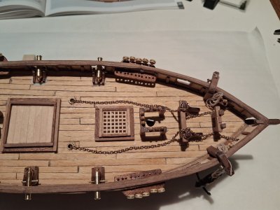

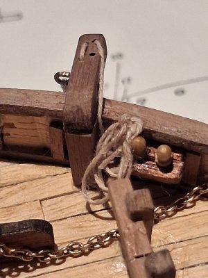

Bitt and bitt cross, while the small one to the right is the Bowsprit Bitt and cross Bitt.
