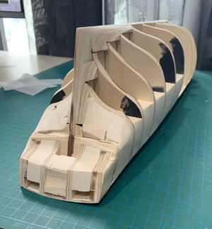

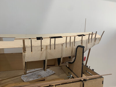

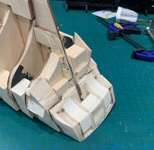

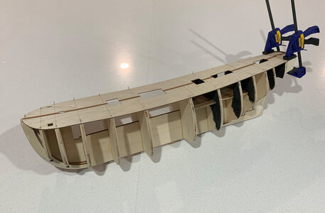

Not happy with the lie of the second whale and how much material I had to remove to fair it so I cut out the bow section and spiled in a new plank. Fits much nicer.

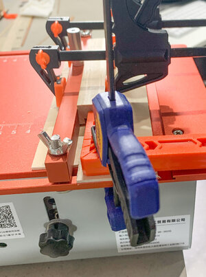

By the way, when I say smile I mean steam and bend the plank on a curved former but also bend it in two planes to mimic a spiled plank as demonstrated with th next plank to go in under the whale. I do have to add additional clamping to assure the plank lies flat the full length of the former.
BOUNTY continues slowly as I have received a partially made EURYALUS scratch build: 1:48 scale 36 Gun ship. She's quite the thing but I do want to keep progressing BOUNTY - 25 planks to go one each side.

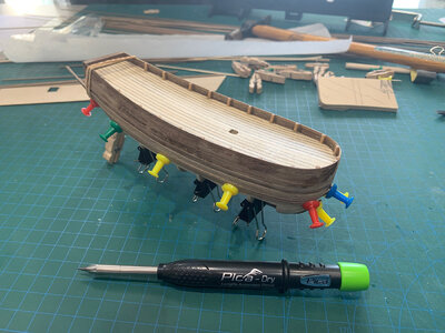

Have laid the Garboard and first strake on the starboard side so I will be working top down and bottom to a batten line. Tapering, bending and a little edge setting to take place.
Have started tapering the planks now. Four rows below the whale on port and starboard and the garboard and next on the starboard side. I need to smile the planks now but in the basic of a nice piece of pear from which to cut the spine, I am trying out steam bending in both planes, effectively edge setting to fit the bow profile. Instead of seeming the planks flat around the form, I am bending them width wise to, then tapering to form the spiled shape, and finally wetting them and using a soldering iron to form the bend around the bow.

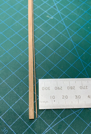

Work has finally recommenced on BOUNTY with the arrival of more pear timber. I purchased 2mm sheets of pear so I could properly spile the bow planks rather than steam bend and force edge set the planks. I have managed 7 planks below the whales fitted in the bent and edge set manner so 8 and below will be undertaken with proper spiling.
