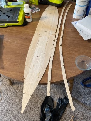

What about building the bulkheads up from the false deck and filling in between them with wood ? Except, then, I’d have to make sure the thickness of the planks was accounted for. Lots to think about. I do appreciate the feedback.I think that your customer will be happier too as he will be getting a mode durable model.

It is balsa. It looks closer to 3/16” when I measure it with my caliper.that appears to be balsa wood that is used for the frames. could use 1/8" plywood instead.
This is a beatifull job! It will be pretty demanding, but I really like this Ship! Keep goin!If Someone was paying me build this model; ie, my time is valuable, I would toss the kit hull parts and buy a piece of 1” lumberyard pine. Using the bulkheads in the kit I would draw a set of lines (above the waterline only.). I would carve the hull like the one in the photo below. There is no reason to plank the hull of a model of a steel hulled ship. For a realistic model you are going to spend considerable time trying to hide the planking and if you are unlucky it will appear again when the weather changes. Besides as others have posted, the planking is fragile.
Building this as a POB unnecessary complicates this project.
