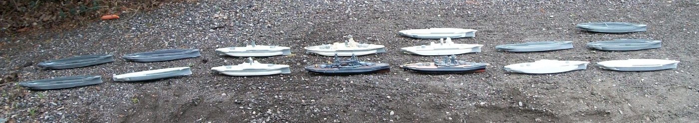

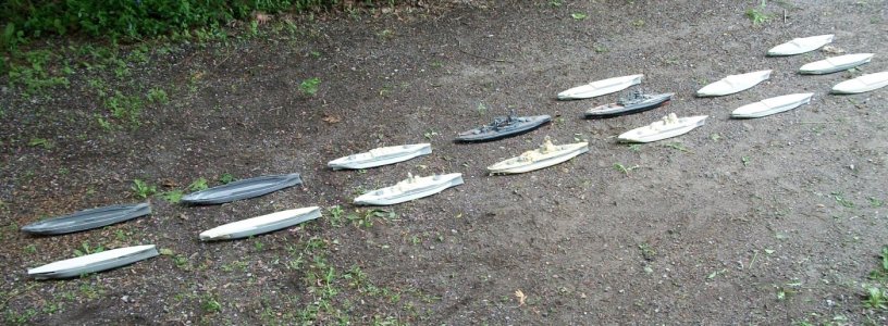

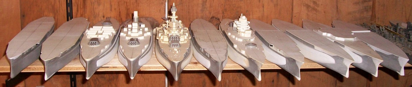

the only pictures are of my smaller scale ships from 1/300 scale & smaller like these using Revell's 1/429 scale model of the USS Arizona to build all 16 battleship from the Wyoming class to the Colorado class during ww2 plus an extra 1 post ww2 as a missile/gunnery training ship.

wow David, thats a awesome collection of ship models.

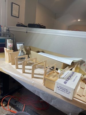

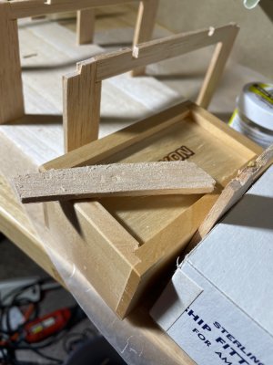

Thanks for the story, Allan! It’s good to hear from you. I’m amazed at how much nostalgia is generated by these old ship models. Keep me in your prayers as I plug away trying to determine which parts go where. It looks like I may have to create some myself.

You getting the strong back established, I might suggest adding some horizontal supports about where the waterline would be to give support to frames when bottom is cut off.
no fancy curves on that hull compared to the real ship so should be easy to waterline it.
Great observations! I will definitely keep all in mind. And Kurt, are you suggesting I’m getting a strong back from all the bending over?;)

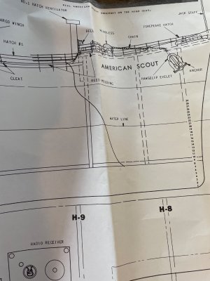

does the kit's instructions show were the waterline is or do you have to find it yourself thru other means?
This is a cargo ship so there are several waterlines. In addition to the Naval Architect’s light ship water line, there are several water lines, or more properly Load Lines assigned by shipping authorities. These are shown by the Plimsoll mark on the side of the hull. There is:

your plans show the waterline is 22' above the keel bottom, is that at empty, standard or max load because the plans i linked earlier shows 25' 9" loaded? find out from your client if he wants the model to show it is empty or loaded as that will change the waterline height.
So, I looked up the plans you sent me. At 25’ 9”, the waterline was halfway between the bottom of the ship and the aft portion of the foc’sle. I measured the plan for the model, and it was also halfway up. They are the same. The model is not quite HO scale. There might be 5 feet or so difference in length in real life. Nobody but you would have noticed. Lol. The waterline at the
stern is a little higher (over 27’).
