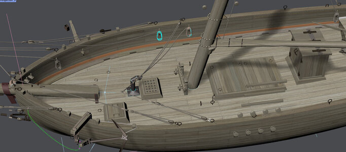

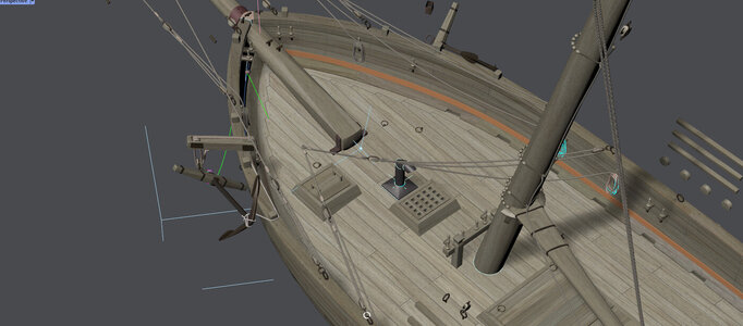

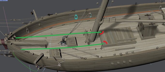

thanks every one, see attached screen grabs
I might do a post with more detail in the CAD section, but a short background, I started with a 3D model I purchased, I have remade almost all of the model, only keeping most of the rigging and iron fittings
This model is of the Armed Virgina Sloop
The book / plans / instructions don’t show a capstan, some people that have build this kit have added one
Here are a couple screen shots of my CGT model, almost done with it, I know there are errors
Not show, the sails and some of the rigging
The hatch, deck items are pretty much per the book / plans / instructions

In this case, as with many period ships, the anchor cable is fed through the hawse holes in the bow to a below deck windlass and then into the cable locker. Thus no cable is fed on deck and down through a grating. The windless can have sections on multiple decks and be used to belay the anchor when deployed…thus the anchor cable would be hauled by the windless section below deck. The anchor cable in several of my models is handled through a bow hawse hole rather than on deck. So in the case of your Armed Virginia Sloop run the anchor cable through the hawse hole in the bow. “HAWSE-Holes, are certain cylindrical holes cut through the bows of a ship on each side of the stem, through which the cables pass in order to be drawn into, or let out of the vessel, as occasion requires.” [Falconer’s New Universal Dictionary of the Marine, 1815 ed.]. When in doubt default to the hawse holes for routing anchor cables…
Thanks! that makes sense, and will look right, in the screen grabs I posted you can see a green curve, I will just lower where it intersects the hull

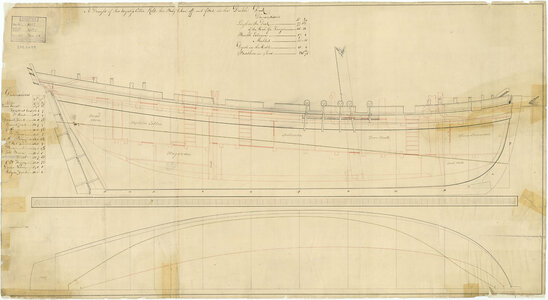

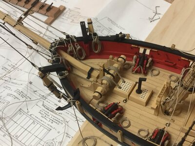

There has to be some method of retrieving anchors. Either a capstan and cable bits or a windlass. Without doing any research I don't know if your sloop had one or the other. My guess would be a windlass. Here is a pic (credit to the other site and builder) which I think is on the right track. Also a draught showing a windlass.
Hi Mark.
Regards AllanView attachment 347519View attachment 347521
thanks, I think this ship, set of plans etc. started with the book: Modeling an Armed Virginia Sloop of 1768 by Feldman, I have and have read that book, there is a kit of this, that was based on the book, I have the kit, and they sell a set of large plans, which I have, none of those show a windlass or other device on the deck
I had come across the build that you show the photo of, and he talks about adding the windlass that is not in the plans
He made a little more fore - aft space by putting the stove pipe on top of the aft grate, and probably moving that grate aft

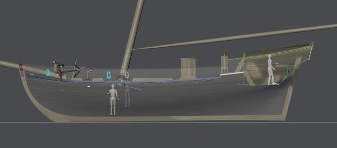

Such sloops were very small vessels, and I have my doubts, that they had enough space and height under deck for a capstan or windlass.
I think on such ships it was on deck.
BTW: usually when the ship is sailing, the opening of the stove pipe should be turned by 180° towards the bow - so the smoke can follow the wind, which is blowing usually somehow from backwards
maybe take also a look at this post I made in the past
Thanks all,
I agree, not much space below deck, not enough to run something with long leverage poles, really barely enough room to walk
I placed a few 6 foot figures in the model
Forward of the mast, the person with a little headroom is almost at the keel, so the deck he is standing on would have almost no width

I have not done it yet, but I plan on trying, running it to the bits, then coiling it on deck
In the book, he says 100 feet long, so that will be ‘only’ 10 coils of 5 feet long
