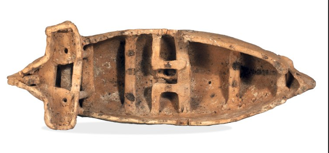

I did some research on Phoenecian boats several years ago. There is almost nothing known except for a few crude clay models found in tombs. Here is an example:
Any modern reproductions will be just a guess, and probably not a very good one.

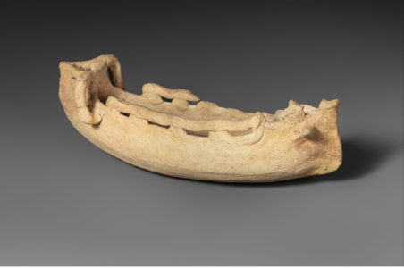

If you Google "Clay models of Phoenician ships" and click on images you'll see the very few that are known. This one might be what you are looking for:
In my opinion the Phoencians were the greatest seafaring people ever, even in comparison to the Vikings. In the crudest of boats they made it all the way around the Cape of Good Hope in around 600 BCE beating De Gama 2100 years. But for the most part they are mysterious, leaving no written records. To my knowledge, other than the clay models there are no other depictions of their boats. You can get a bit more info by spending a few dollars omn a used copy of "Ships and Seafaring in the Ancient World" by Lionel Casson. Good luck on your project. I'd be interested in what you decide to build.

Thank you for the additional quartering view. It will definitely be a significant resource in drawing up the lines for a model which is a project in itself. Rich

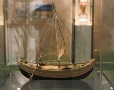

Coincidences do happen. Right after I got an email from shipsinscale with your reply, I received an email from a site that sends me notifications of publications on nautical archaeology and it had the title:
PHOENICIAN EXPLANATION: EXAMINATION OF PUBLIC INTERPRETATION FOR THE BAJO DE LA CAMPANA SHIPWRECK EXCAVATION
You can read the paper at https://www.academia.edu/9313460/PH...IPWRECK_EXCAVATION?email_work_card=view-paper
It is about how museums display historic ships, but there is a good discussion of the Phoenician ship found off the coast of Spain and also the Uluburun wreck found off the coast of Turkey which might be just what you are looking for. It is of the right age and models have been built so some searching might uncover plans. Here is a pix of the model from the web:
Hope this was helpful.

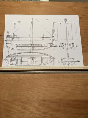

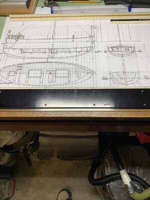

Downloaded a Zip file with the plan sheet in TIF format which took a lot of work-arounds to finally get it printed out onto an 8.5 x 11 inch sheet with a top notation of 1:100 but without anything dimensioned for reference. I saw a crewman standing forward on the deck of the elevation drawing and made an assumption for his height, centuries ago, at 5"-6" and then used both my multiple point dividers to determine the boat length followed up by my engineering scale.
and estimated a length of 67 ft. followed up by using the scale
8.5x11 plan with engineering scale.jpg8.5x11 plan with engineering scale.jpg
Taking the letter size plan sheet to the local copy shop I had it printed out twice the size for a model which would be just over 13.6 inches long. Now to do some drafting to create more transverse sections for a mold around which to bend the edge joined hull strakes simulating the Bronze Age mortise and tenon joinery method. I'll post the progress as I go. Rich

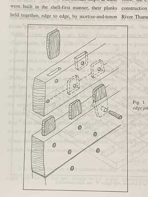

Starting to draft hull cut lines and transverse angle cuts to develop more transverse sections for a hull mold where the planks are set and connected edge to edge without frames.Mortise and Tenon Construction.jpg

Starting to draft hull cut lines and transverse angle cuts to develop more transverse sections for a hull mold where the planks are set and connected edge to edge without frames.View attachment 254353

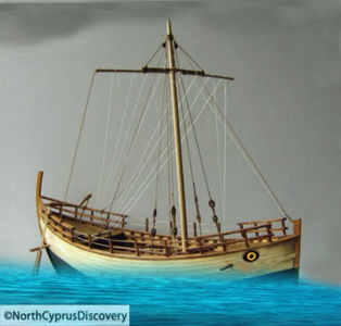

A friend who studied underwater archaeology in the Eastern Med. sent the following image of one interpretation of a recovery model from Kryenia in the Aegean Sea which I will use in part to modify the plan model being my own best melded resources examples scratch build.
