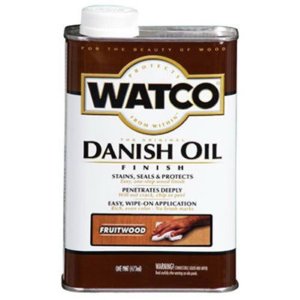

Dear fellow builders, I would like to buy this oil for boats finishes. Is it any good? View attachment 128556 Any suggestions?
Hi
Have used it many times for deck planking but find wood glue does not stick so once dry it needs scrapping back to apply any item of wood using wood glue. I stopped using it!

Back in the 60’s I had no experience with any finish oils so I bought a small can of all to try including Danish oil. I don’t remember which one was the best but I remember the rugs from one of them was flammable, not instant but when you left them for garbage they will ignite. So try to store used rugs in a metal container and out in the yard.
I used Danish oil on my Roter Lowe and the results were great. Some people have said to steer clear of using oil instead of varnish because oil could be a dust magnet, bu I haven't found that to be the case.

When using any of the oils you MUST be aware of spontaneous combustion. The rags will heat up as the oils degrade and will ignite, the process does not take long, be very careful. Soak used rags in water and put them in a an old paint tin with a tight fitting lid. You can also burn them (in a safe manner).
