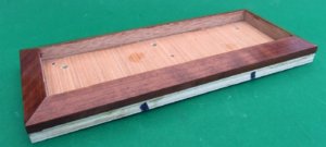

Do you have any picture of final product? Also how many layers are you applying? I read it should be 4.

After reading the above, I went out this morning and purchased a tin of Tung oil - It sounded more suitable for what I want to do. Polishing the base and display case edgings. I had already put some undercoats of laquer on the wood and rubbed it down with the fine steel wool. The first application of Tung Oil gave it a beautiful finish that is just what I was looking for. it remains to be seen whether it will still look the same after it has cured!
