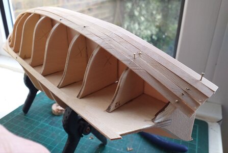

To answer your query I didn't plank the deck at the start and that seems like a good idea of yours but I am where I am now (hull cladding finished, just awaiting a coat of matt varnish, section 7/p.14).
I take on board your thoughts about smudged pencil 'nails'. Not having built a boat before I'll have to don my model making problem solving hat to see if there's an answer.

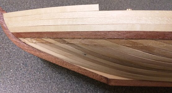

I'm now 1/2 way through the rough hull planking and finding some interesting curvature at the bow ...room for either stuffing it up or making it real nice.
Yours looks really good...
