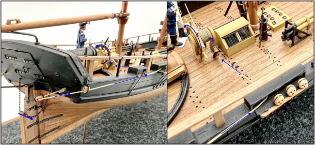

First rope on board. I did the rudder rigging and secured the oars.
Kit included blocks are top notch, the same dry dock is selling. PE Parts for the blocks are a fail ... way to big and not adjusted to the coffee bean shape of the block. I used served stropps though.
I also did the cahins for the rudder.
cheers

Ah ha, I've been waiting to see the application of the rudder iron. This must be an accommodation for the stern armament (no tiller possible).

A nicely rigged rudder, Dirk.
But ....... is the winding on the steering wheel shaft correct?
In you situation: I you want the ship to port, you turn the wheel to port (anti-clockwise). Then the shaft pulls on the rope on the starboard side and pulls via the block on the aft on the starboard side of the rudder blade. Then the ship ...... turns to starboard.
Or am i Wrong ......?
But what would be the right way to do it then?
Bring both ropes feeds to the underside of the shaft: when the wheel is turning the same way anti-clockwise, then indicate the shaft length to the rope on the starboard side and wind it up on the port side. The port side rope will pull the rudder to port and the ship goes port. :)
Thank you Peter. Makes sense, I wonder why I did not saw that on other builds yet. Not sure I will change it though :-P Although I’m already thinking about it – there’s one too many coils on the drum; there should only be five, and somehow I think the rope (0.4 mm) is a bit too thick, but I’m not sure. We’ll see.
Good observation. I was just about to write, but you beat me to it, and with the solution too.
As a rule, 95% don't even notice this, but I would fix it)) but I always find myself unnecessary problems))
I have to mention/document it somewhere.

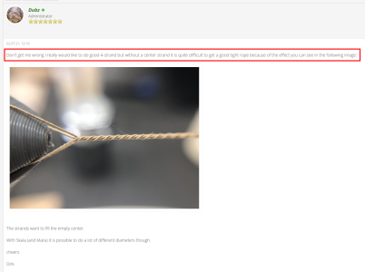

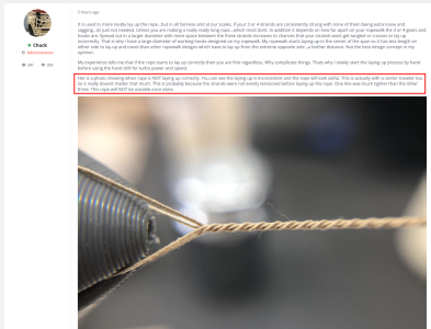

Today I found the following on MSW by anti pirating Chuck Passaro, pirating MY image and even worse set it in a totally wrong context. Another sign of him lying and/or having no idea about rope (he is still selling left handed hawser what is historical wrong), sorry, I am pissed at the moment.
The following is the context of the image:
This guy sux in his intrigant attitude ...

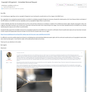

MSW has now closed the "Masting, Rigging and Sails" section to the public (as others too), meaning users must be logged in to access it. As I have been banned, I can no longer view the content myself. However, I have been informed by a colleague that my image is still being used without my permission and still in a context that makes me look bad at that.
Mr. Passaro was made fully aware that such use constitutes a violation of intellectual property rights — an issue he has consistently claimed to take very seriously. Despite this, he continues to use the image. I find this level of hypocrisy and apparent bias deeply concerning.
I’m sorry for hijacking my thread for this, but I feel it’s something that shouldn’t go unmentioned.
Sorry to hear that my friend, this is clearly far from the values “they” advocate. Blatant double standards.
