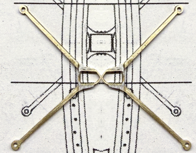

I made the metal tiller. There is a photo etch part in the kit I don't think is completely thought through. It should be folded and then ...?
Anyway I found a method that works for me. I folded at the other side direction, soldered the folded parts (green) and then soldered a brass strip (red) with the contour of the rudder head so that the parts fit the rudder head :-)

I understand your point, but I actually see it differently in that it makes it more difficult for the customer to build. Let's take the tiller as an example. The way it is currently included is simply nonsense. It should have been made as shown in the following picture, then it could have been folded and would have fit better no matter what.
