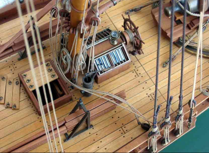

anchors, boat, steering wheel and pumps are 3D printed parts in different quality. anchors are nice, boat is ok (not finished yet), steering wheel .. mm I don't know (still needs some fixes), the pumps are square completely wrong crap (pumps not shown), I will need to scratch them. PE Parts of the kit are good, just to mention it.
Overall look at the moment. Channels are done.
The anchors, sprayed black and the using pencil dust (no idea how to call it) to get a metal finish.
Some more details aft, washer for the rope passage. I usually have lots of micro parts like washers, rivets, nuts and else in my stash to "pimp" details.
The boat, not sure about coloring yet.
The steering wheel.
The aft area.
