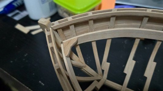

As I worked on the aft inwales, I decided to go ahead and add simple breasthooks at the bow. I forgot to take a photo of making the larger clamp-level one, it was just a slow process of shaping it to fit. I wasn't that concerned with the shape of this one as it will be covered by the foredeck.
I think the breasthook does make the bow area look a bit better.

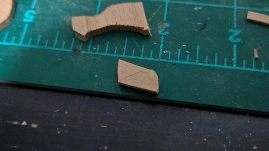

For the upper one, I traced the outline of the shape on a bit of alder to start.

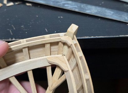

And then began trimming, especially with a chisel. Although I marked the midline on the aft side, I decided to glue the piece in place before finalizing the shaping, as it was very tricky to file such a small piece when holding it by hand.

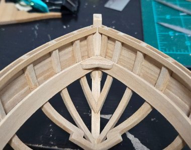

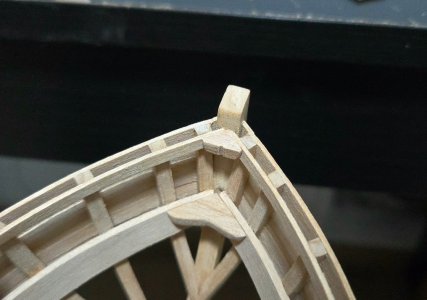

And after shaping:
I do think it adds to the realism of the build, I imagine they would have had some sort of breasthook on the actual bateaus.
