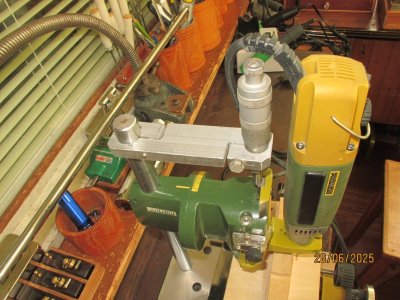

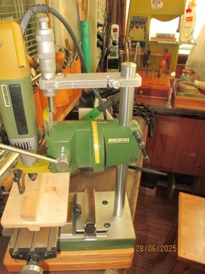

For my micro drilling and milling, I’m very very happy with this arrangement on attached picture. It has a vertical stopper adjustment. This allows me when milling repetitive details to lower a milling bit very quickly at same height. I hate rotating a vertical wheel on a regular milling machine for repetitive tasks like this. My Sherline milling machine has huge vertical backlash and you never know where is your milling bit vertically. It neither has a vertical stop. I wonder why? I have a Sherline milling machine for more serious work.

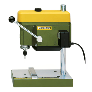

I would love to try Proxxon drill press Jimsky showed at beginning of this topic. It seems to have most of what I need to mill or to drill.
